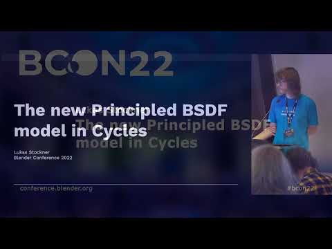

    I also found this video interesting about the future of the Principled shader and the explanation about the purpose of the actual one.
    Arists tend to use the shader in their way, without really knowing what the implementers intended. We will come to a certain degree of realism, but I also try to create a set of assets to tell stories and define a personal workflow and I always have to keep myself from always trying to be perfect.
