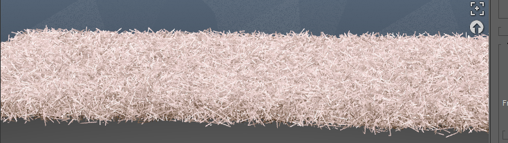

    I just took a shot at using SBH, and here is what I was able to do within the editor:
    I painted an area on a plane, went HAM with the brush tool, cranked up the random root angle parameters and the frizz. I haven't had much luck making it render like straw, but I'm also not trying very hard.

    Very cool effect. So many uses...shag rug anyone?
