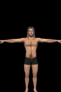

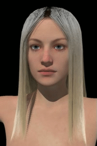

  • JonstarkJonstark Posts: 2,569
    Luckily it's a little slow and I've been able to play around to test. Forgive the quality of the hair and the animation, this is simply a very quickly put together silky longhair style that I put together on the low-poly genesis envelope's disembodied head while it was on a V4 character (the same default character from my earlier videos in fact). I added low poly proxy figures for the chest and the left and right collars, and after making sure everything looked halfway right on the V4 I got rid of the V4 and loaded up a Genesis1, specifically the M5 Heroic Genesis.
    Quite a bit different in body size! But I simply moved the genesis head with the hair up until it was sitting over the M5 head, did the same with the low poly invisible chest proxy I made (I didn't end up using the collar proxies as I didn't need them for this experiment) and dropped the invisible Genesis head onto the M5 head in the instance tray, and the invisible chest on M5's chest. Ran a simulation with M5 doing the head shake, and here's how it came out. Aside from the fact I didn't retexture M5 and his eyes look like he's possessed by demons, not bad.
    Seems to work fine so far, but I need to do further testing. Next up I'll try it on Genesis2female, then Genesis2 male.

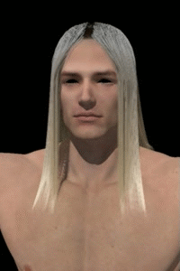

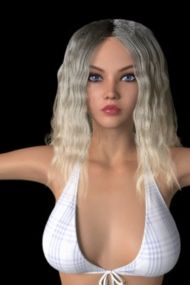

    edited February 2015
    Work got busy and prevented me from experimenting the way I wanted, but I did manage to put the exact same hair on Genesis2female, works just as well (see attached).
    I'll try to put together a quick tutorial (not like a real tutorial but just showing what I did to make this work) later on, and maybe put the hair on sharecg or somewhere (never done that before, so not sure what's involved), just to demonstrate the concept in action.

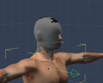

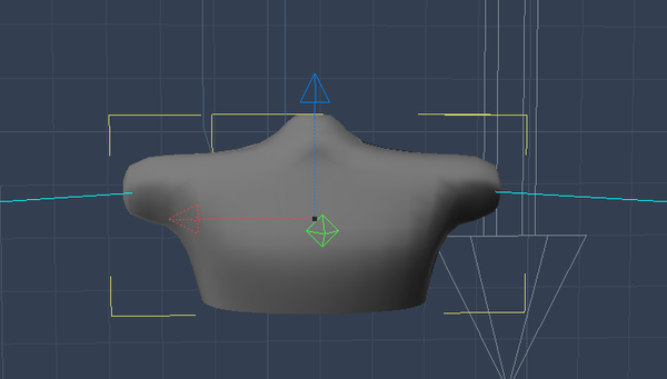

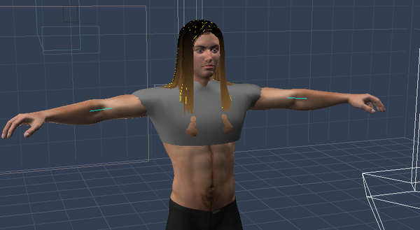

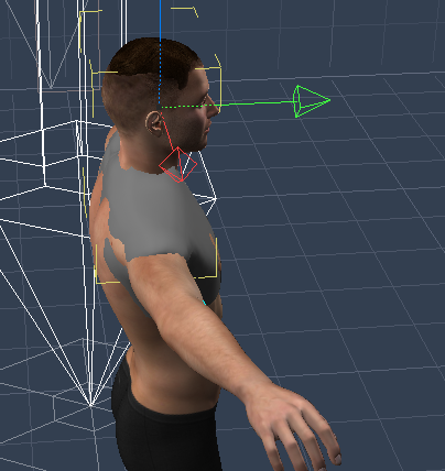

    Also I'm only using 2 proxy collision objects, one for the Genesis head from Diomede's excellent low poly Genesis envelope he was so generous to donate for use on sharecg.com (though I manually added a few vertexes to the top of the skull area to make it give it just a bit more polygons to be more precise with where I draw the hairline), and also the chest area (along with extrusions for the shoulders and neck) also pulled from the same proxy figure. Here's some screenshots, first of the Chest Collider object (which is simply dropped on the chest bone of whatever figure you're using) and the severed Genesis head which I create and grow the hair from (again, just drop this on head bone of whatever figure you're using) and the hair appears to work fine as a universal object.
    The more I play with it, the more I'm finding I don't think I need separate collision objects for the shoulders/collars/neck, it can all be part of the chest since the chest is connected to all those areas anyway, so this makes a universal solution less complex to implement. Not a 'one click' solution, but maybe a 'two click' solution :)
    Here's some screenshots, first of the chest object, then of the head object. Seems to work fine, and I can transfer the same hair from figure to figure, just do a bit of resizing and moving of the collision objects to match up with whatever character I'm putting them on.

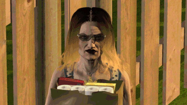

  • argus1000argus1000 Posts: 701
    Thanks,Jon, for the advice on how to make shoulders from Diogene's envelope and how to use the directional force. As you recommended, I also added only 2% of shape stiffness. I also added more hair guides and extra polygons around the center of the head for the hairline. But, as you can see, that did nothing for the shimmering or jitters we observe in her hair.
    I think you are going in the right direction. It is left only for me to play some more with the settings, maybe with the hair or root stiffness. Or maybe is it a shader room adjustment?

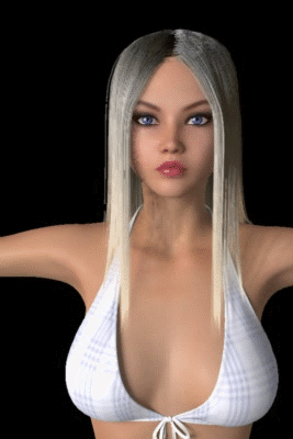

    Phil, are you certain about this? I haven't had time to do much testing, but I'm not seeing it so far.
    Since all the shaders don't actually change the shape of the guide hairs at all, only the way the 'loose' hairs that are visible are rendered, when relying on a hair shader to get a hairstyle it does mean that the underlying sim will still behave only as the guide hairs would normally move in simulation, and for example if you've got straight guide hairs and then put a curly/kinky hair shader on them, then the movement of the visible curly hairs has to follow the movement of the straight guide hairs, which means in certain circumstances the hair will appear not to move correctly (most commonly hair appears to suddenly jolt or crawl over the shoulder instead of flowing naturally, because the hair shader has to follow the underlying guide hair's movement).
    There's a tradeoff though, and a reason not to simply shape the guide hairs in the modeling room and let that be what makes hair curly/volumized, because if you don't set any shape stiffness it will all fall straight out under the influence of gravity and within a few moments of the animation the hair will have lost all curls and volume and be completely straight again. On the other hand, if we amp up the shape stiffness to preserve whatever shapes are set in modeling/brushing the guide hairs, then you've got a stiffer hairstyle that doesn't move and flow as freely/naturally as perhaps it should in the animation. I've been approaching the problem by assigning 'real' curls/volume to the guide hairs at specific points that I don't want to move much anyway (say the bangs or the bits that frame the face) along with a shape stiffness to preserve the look, and then using hair shaders on straight guide hairs in areas where I want the hair to appear to have curl/wave/volume but still have the hair flowing loosely.
    Here's an example vid first of the underlying straight hairstyle, so it can be seen how the guide hairs (which have no shape stiffness at all) are moving and reacting in the scene, then on the second vid the only changes I made were to add a Kink shader to the existing hair simulation (nothing else). I also used the scale to widen the invisible low proxy head/envelope so that the volumized hair wouldn't fall through V4's cheeks, but it's running the exact same simulation I did for the straight hair (I didn't do another simulation).
    267 x 400 - 4M
    267 x 400 - 4M
    edited March 2015
    Hi Argus, actually they are exactly following the guide hairs, and this is actually the reason for the jitters at the shoulders. The guide hairs are straight and don't have curls, so move differently then they would if they were curled. The hair shader has curls/waves but has to follow the straight guide hair's movements exactly. The actual motion of the hair is exacly the same as in the animation with the straight hair, and due to the fact that I had no friction on the invisible chest collision object I was using, they slide way too easily over the shoulder. It just makes the straight hair look 'slippery' as it dances back and forth over the shoulder, but with the kinked hair shader, it means the hair has to 'jump' quickly over the shoulder in a way that isn't natural for hair movement. The jitter is exacerbated by the fact that I did only one hair simulation, the first one, where the straight hair is much closer to the face, neck, and in the second animation with the curly hair I used the exact same simulation, but used the x scale to make the invisible head proxy object even wider (I did this to try to avoid having hair fall through the face of the V4, but a side effect is it moves the actual hairs farther out towards the edge of the shoulder an even beyond, which means that the side edges of the kinked hair is jumping over empty space beyond where the actual shoulder is.
    That's actually a separate and different issue/problem then what I was testing for, so I didn't care much as I wasn't going for realism in that area, which isn't so much concerned with the natural movement of the hair over the shoulders but instead I was looking at the body of the hair above, as it moves and sways to see if I could replicate the problem PhilW was describing above. I couldn't in my short animation, but when you mentioned maybe it takes a longer animation to spot it, I decided to make a 30 second animation, again just using a couple of added aniblocks to my beginning headshake pose. I didn't fine tune the hair shader and the highlights are too high, making it to shiny glowy, and the hair is too reactive to the abrupt up and down movements V4 makes during the walk cycle, making it judder slightly more than I would like, but that could be adjusted by tinkering with the scene forces and the air dampening level and again that wasn't what I was testing for. Nor did I do anything fancy as far as the hairstyle, just added a kink shader to the extremely basic hairstyle, but even in a longer animation I'm not running into the problem, seems to behave in a fairly stable fashion. Perhaps it's only a problem with short hair/fur, or perhaps I'm just lucky? Will do further testing. Also putting this hairstyle up on sharecg so others can test.
    Full version of the animation at larger size: http://youtu.be/vQZHl2BuT-M
