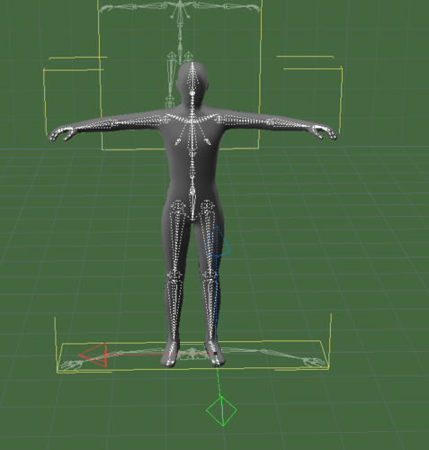

    Am anxiously hoping for somebody who can distribute a Genesis low res-proxy figure with skeleton.
    Actually, I think the universal solution is applicable right now. Cut the head off your v4 proxy that has the hair and get rid of the body, then you can drop that proxy head onto any figure (a little pushing and pulling of vertices and it will fit the head of whatever figure). Throw in a few primitives that you can also push/pull to get a closer shape match onto whatever body parts you need to collide (for example, a cylinder for the neck and a couple of cylinders on the collarbones) and you can take the hair you've created on the V4 proxy and put it on any other figure, including genesis.
    Diomede's got that cool low-poly genesis envelope figure, it's unboned, but is also very useful as well (you can find it on sharecg). My own testing so far though leads me to believe the conforming low proxy figure won't work well with Genesis and Genesis2, the autofit is too strong and makes the low poly figure shred in places sadly. There may be a way to bone it so that it follows Genesis without the autofit, more testing is needed, but like I said even so there's a solution to make your hairset universal for any figure (though it does require a bit of fiddling with primitives for the hair to collide against).

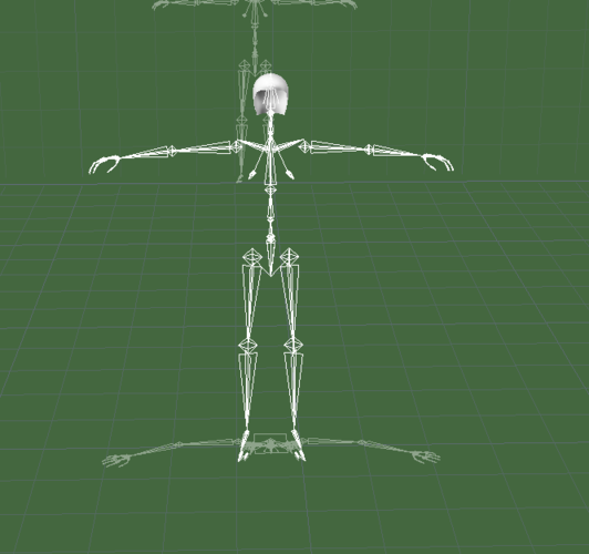

    I found out that Daz distributes a Genesis hair cap with skeleton. All I have to do is attach the hip with Diomedes' Genesis proxy (with the "attach skeleton" feature under the animation tab) and I'm in business.
    https://www.daz3d.com/downloader/customer/files#prod_17109
    I am eagerly waiting for your free hairstyles!

    Very very cool about the Genesis skeleton working so well with the proxy envelope, didn't know that was out there, excellent find! :)
