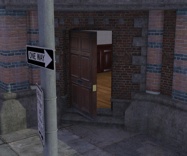

Here's a quick example of what can be done with a few basic tools. The building is from Urban Sprawl 2, and the door is merely a cube which borrows from the original models textures so that they would match. I added a couple of extra cubes, one to act as the plate for the lock and another for the bolt which was deformed into a wedge.
The room beyond is the living room with a few items inside made invisible by changing the opacity to zero. All in all, took maybe 10 minutes to do. Very quick and dirty, but it shows what you can do with a little time and imagination.
