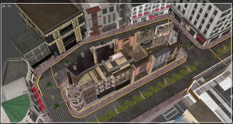

    Not all of them as there are a few colour variants for the product, but with the the scene loaded out of the box, it really does gobble up vram very quick.. One thing is that while the product does make quite a bit of use of instances, it still does not delay the fact that the product is still very resource heavy..
    Either way in the end after reducing the size of the textures to 2048 x 2048 (going any lower makes some areas look terrible), and removing the normal, roughness and bump maps and removing and turning off the metalilcity setting..
    I also turned off the Sub Division Level and Render subD level to 0 via Scene Optimizer (as a lot of the elements in the product do have a SubD as well), I was able to get the vram usage to just over 6GB.. Still not ideal but better than before, though thinking about it now after I start adding in characters and so on I can see the vram usage will max out my card again..
    Also trying that idea Richard had said about changing some of the textures, I ran into the problem as shown in the image below.. Selecting the back portion of road also selected another portion of road as well as some of the sidewalk and a portion of the gutter.. sad
