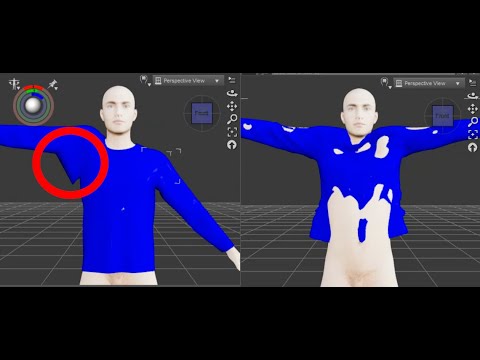

    Okay you have the top and pants as one clothing piece. Might be more advantageous to make them as 2 separate pieces.
    I saved the "cloth" obj as a clothing piece. And then using your morphed .obj made one pJCM. Images attached to post.
    I tried to make a couple more BUT the morphed .obj files you have, some of them need to be redone. If you pose the figure, then do a straight import of the morphed .obj file, you will quickly see which ones need to be redone.

    I tried to morph only the shirt but always the same problem. I think the problem is that I made them with marvelous. When it does the simulations, one for each pose, he changes everything. For example, if you lift the shoulder, it will not only change the area around the shoulder, but will generate creases on the belly, shoulder and even the wrist. So if you have a pose where the character has the torso bent and the arm raised, there should be a morph that changes the torso area and one of the shoulder, so instead there are two for the shoulder and two for the torso creating interference. Is there no way to tell daz to only consider part of the morph? Because it would be a shame not to be able to use marvelous.

    Okay, took a look at the new files. It's okay to delete all of those now 'cause friend you're going to need to start over anyways.
    Couple of tips: .duf files do not import. There's a folder arrangement required when sharing those which can be covered later. Esp. while learning, it would be an idea to NOT encrypt your files - makes finding where you put everything a little easier ;-) Also save the files to the appropriate locations.
    I imported the cloth which now is just the top. Okay. I ran the utility and made it into a clothing piece. Not so okay. BUT the good news is, that once you get all the necessary steps figured out, yes with M.D. you can make marvellous clothing "for" use in Daz Studio.
    The curves on the seams illustrate that the seams are not welded together. You want these welded together.
    Now while I do not own M.D., I have imported a number of clothing .obj files made in M.D. - and sadly most of them are not worth the time required to 'fix' them. So far, you have it right -- single mesh! Yes. It just needs to be welded.
    Now, this I do not know, but if there's a way to make the clothing, single mesh, welded together and NO seam tubes ... paradise!!!
    Otherwise it's a trip to the modeler to remove all the seam tubes and weld the sections together. Then the uvmap would need to be redone too of course.
    Headus UVlayout is 'the' uvmap maker of many {industry standard somebody said}. Or of course in the modeler of your choice. {if the model can be made all in M.D. and it does the uvmap too, that's great.}
    Once you get just the top finished, saved, THEN work on just 2 arm morphs. Let's get the workflow happening first.

    So the problems you have found are mainly two if I understand correctly:
    1) The morph must not modify the whole object but ONLY the interested part
    2) For the "fault" of the marvelous seams it is as if the shirt were several objects close together, not a single object. All seams or just the back seams?
