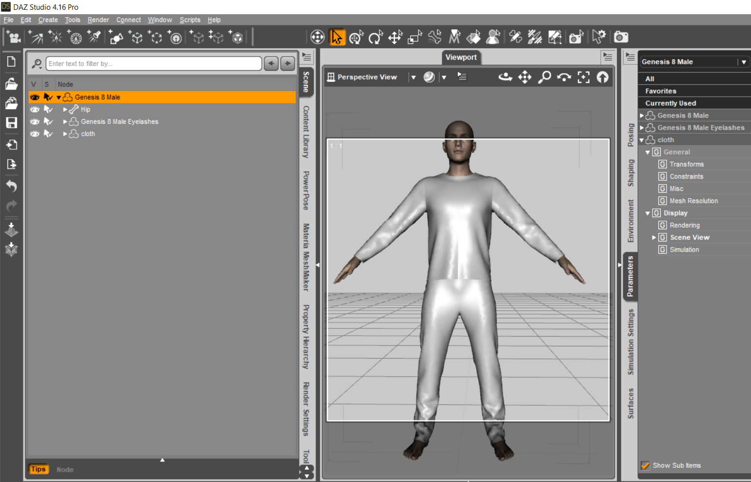

Hi everyone. I have created a 3d obj model that you find here but when I load it with the transfer utility, it makes me this defect in the armpit, even if there are many vectors. how can i fix it? Thanks
Solution: Thanks to this thread I created this tutorial
1920 x 1080 - 1M

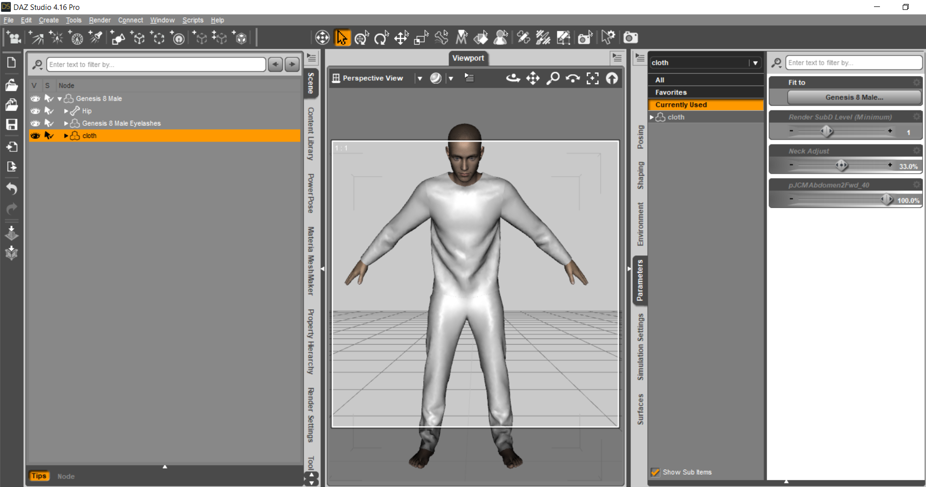

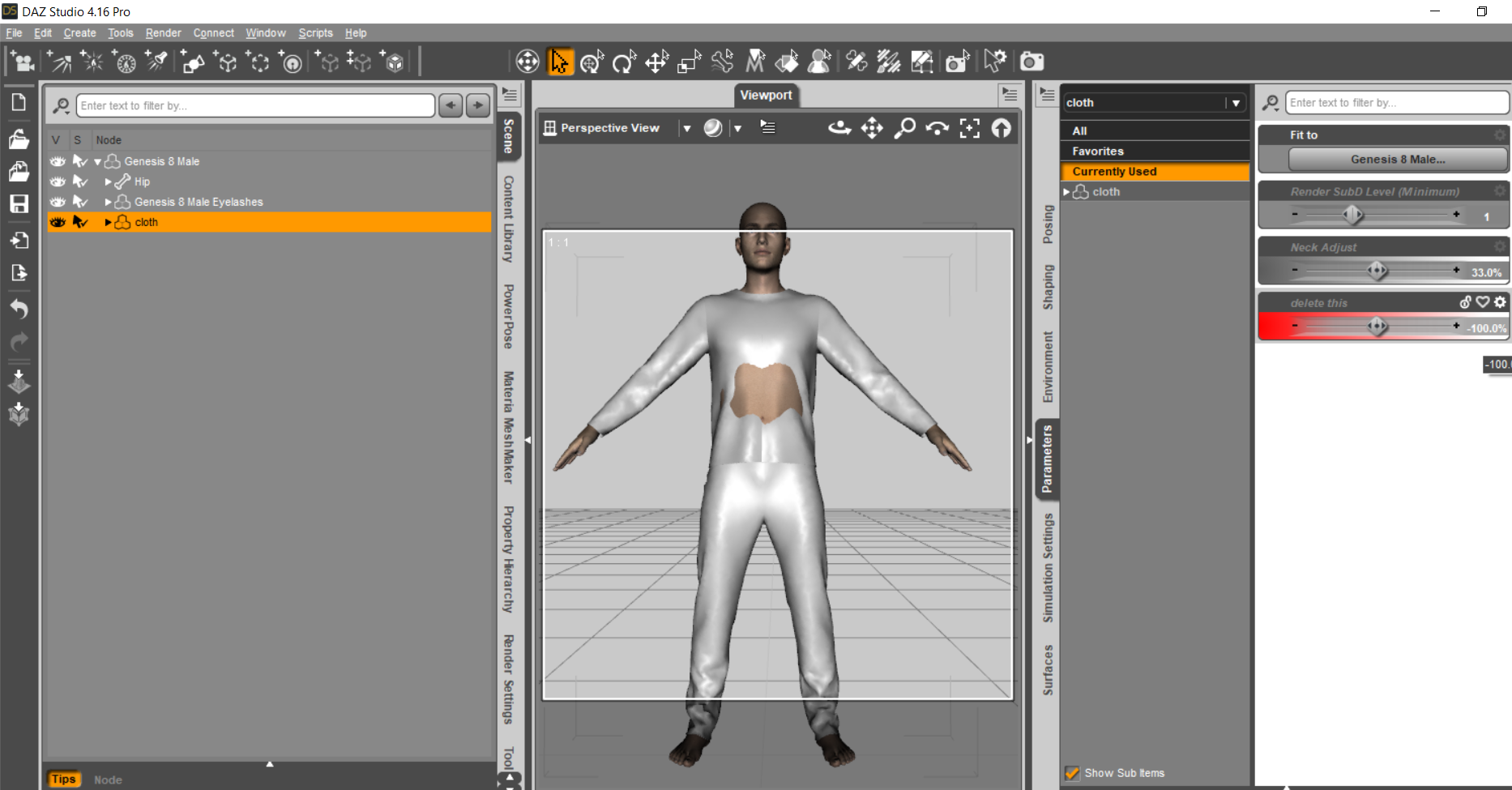

    Thank you very much for your reply. With Reverse Deformations it works! But if I change the pose it gives me other problems, no longer in the armpit, but on the bicep and on the wrist. For a still image I can also create the suitable morph, but if I wanted to make an animation would I have to create infinite morphs?
    1920 x 1080 - 1M
    1920 x 1080 - 2M

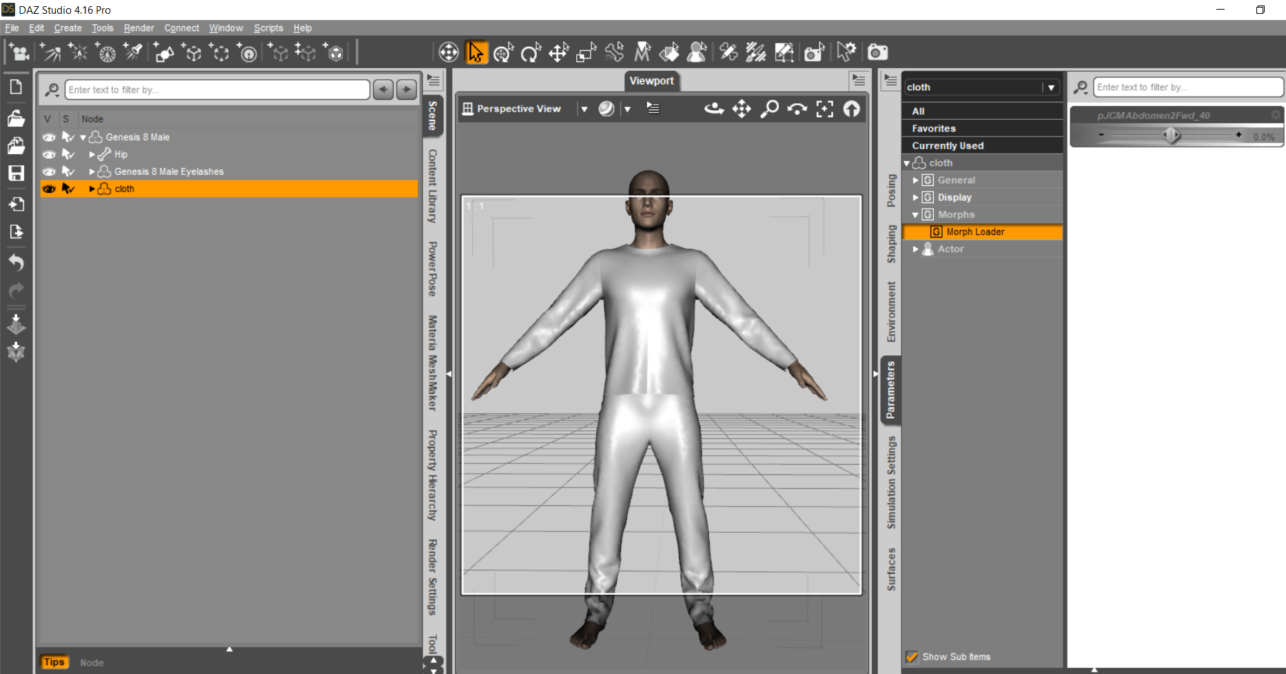

    Thank you very much for your reply. I'm sorry to be so insistent but I don't know how to search this thing on youtube or google, if you want to recommend a keyword or a video that's fine for me :)
    Attached what I see in the parameter settings.
    Thanks
    371 x 490 - 35K
  • Richard HaseltineRichard Haseltine Posts: 111,734
    Is that morph on the figure or a morph on the clothing? If you are wanting JCMs then you would want, possibly, to match the name of the JCM on the figure though you can also drive them directly from the clothing's joints.

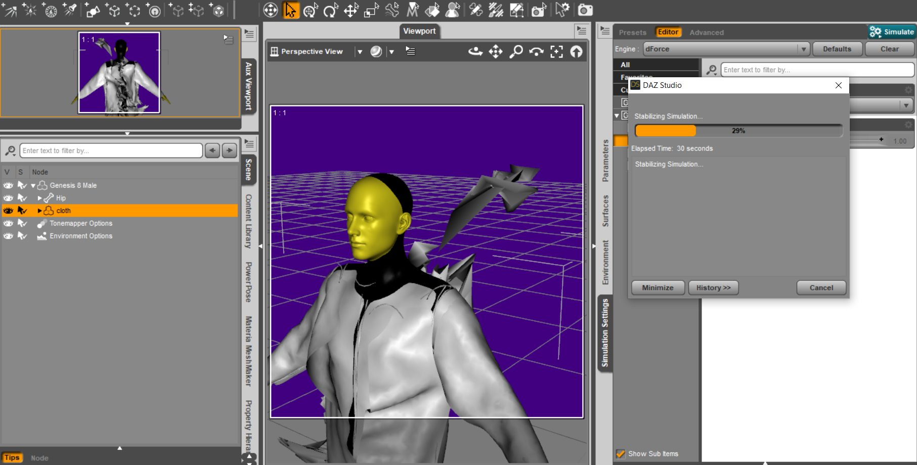

    Thanks for the help. The problem is that the poses are endless. If you choose a more complicated pose, like the one in the attached image, many morphs are activated and disturb each other making a mess. How do Daz store clothes work in every position?

    They don't. That's why many love dForce ;-)  While using dForce, the morphs will still be dialed in but hopefully dForce keeps them outside of the figure.
    It is possible to make additional morphs FOR a particular pose set. These could be dialed in manually. Or once again, there is a way to make a controller dial to trigger a particular pose morph when a particular pose is used. Tutorial is in that same basket at DA, called "Making Pose Controls for Correction Morphs." n.b. I am not a PA, not privy to the PA forum so they may or not also have additional information on how to do things. Don't go nuts trying to second guess all what poses people might have for their figures, there are way too many. The Base Poses that come with the Default Genesis' figures would be possibly the start and end point of such a product - unless of course also is selling pose presets in which case one may want their clothing products to look nice with all their pose presets too. PAs tend to specialize though, one makes clothing, somebody else makes poses, etc.
    While over there at DA, might want to also check out my Tutorial for making FBMs - another necessity to help clothing fit at least a number of core characters. Core characters are the ones with the # of Genesis in it. i.e. "Name of Character" #. AFAIK to sell clothing at Daz3D one is expected to put as many of these core character FBMs into their clothing as they can. Not everybody owns "all" the core characters however something of a collection of them is expected. Esp. for Victoria for the females and Michael for the males, for example. And yes, there just happens to be a tutorial in my folder over at DA for this too, called "Making Replacement Full Body Morphs."
    I pretty sure that many people make some clothing for themselves, making only the morphs they require for their own work.
