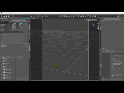

    I made a quick video showing the process of loading a Generation 8 figures Shape and Materials set on the Genesis 8.1 base. This then allows for the use of outfits that are made for Genesis 8.1 on your Generation 8 characters.
    https://youtu.be/DsAmpW8sTvc

    Thank you for the video! Very helpful! :)

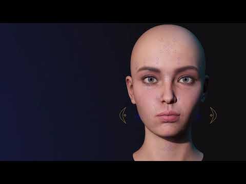

    Aside from the new UVs and skin shader (which is where my interest lies) there is the facial rig seen in this video:
    The DAZ info page on Genesis 8.1 is here: https://www.daz3d.com/genesis-8-1
