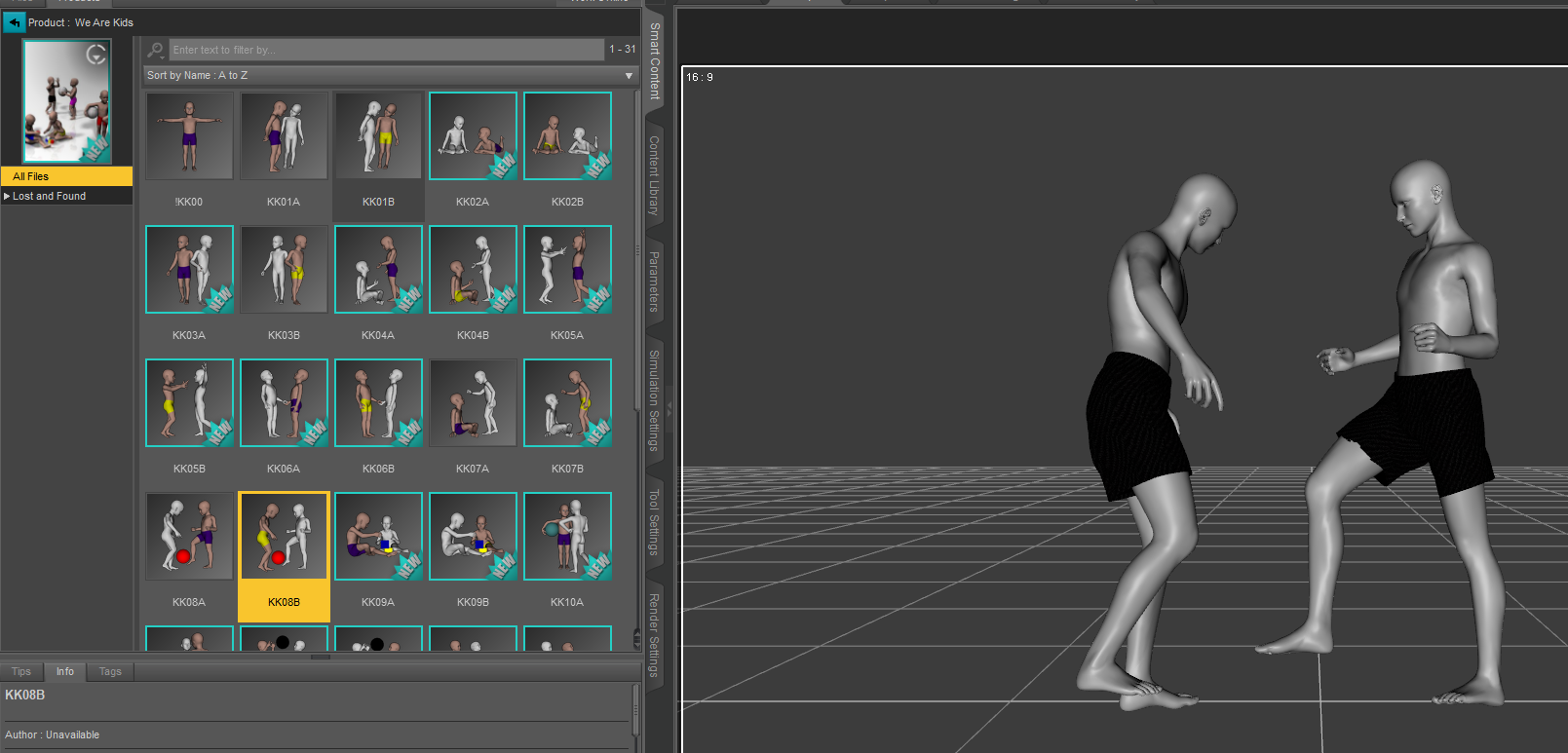

    Here i have used a Kid4 pose set with Genesis. There obviously need to have some adjustment but these are out the box.
    1609 x 773 - 360K

  • HavosHavos Posts: 5,705
    nabob21 said:
    Tugpsx, are K4 poses the same as V4 poses?
    All the generation 4 models, ie V4, M4 and K4 share the same bone names, and thus poses built for one model can be applied to the others. Naturally some (normally minor) adjustment will be needed due to the different bone lengths, much the same that a G8F pose applied to G8M will need to be adjusted slightly. Since K4 bone lengths are more different from V4 than M4 then likely K4 poses would need more adjustment. For example a hands on hips pose is likely to end up where the hands are slightly away from both hips.
    Due to what I have said above, then converters for V4 will work on M4 and K4 poses as well. There is a V4 to G2F pose batch converter available from Zev0, as well as G2F to G3F and G3F to G8F. Using these you can get a V4 pose to work on Genesis 8 (male or female), and likewise a K4 pose from K4 to either Genesis 8. As stated above, the final pose will not look identical, and so will need adjustment.
