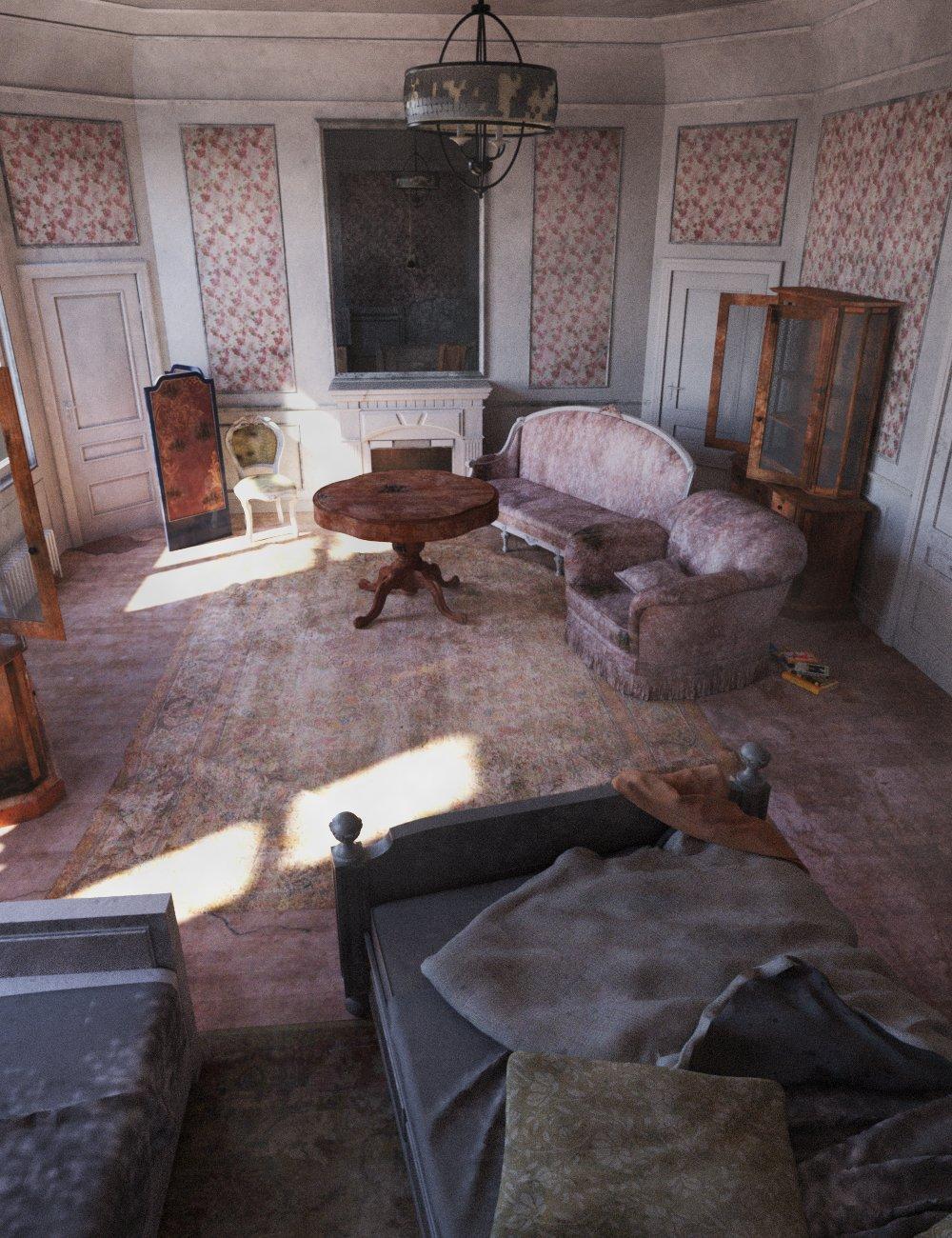

I really like the small, elegant interior environment in the Tesla Abandoned House.   The muted colors are great for portraiture - the product promo picture is below.
