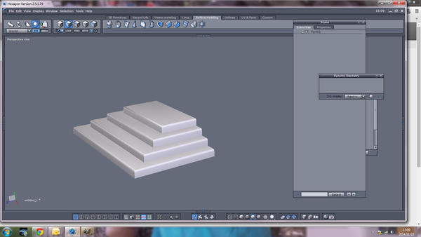

  • RoygeeRoygee Posts: 2,247
    edited November 2014
    Clever method you used to work out the size of each step :)
    Just to show that there are more ways than one of skinning a cat
    Once you decide on the size of the bottom step, make a cube that size and select multiple copies - start off with just one and experiment with the offsets - hit enter each time (it doesn't commit until you hit validate). I haven't found a formula for this, so it's pretty much trial and error to get right. In this case, the offsets were X=0, Y=0.74 and Z=1.5. Once you have the offsets correct, increase the number to 3. Validate and ungroup.
    Next, go to front view, select all the steps except the bottom one and scale down on the X axis by pulling on the little cube on the axis indicator (using universal manipulator). You can either eyeball for size, or make a cube as a marker. Then do the same with the third and fourth step, then again with the top step.
    Select all the steps and weld. Delete the back, top and bottom faces on all the steps, excepting the top face of the top step.
    Loop-select the top edge of the bottom step and the bottom edge of the second step and bridge. Repeat for all the steps.
    Select all the back edges of all the steps and make the size on the Z axis = 0. For a nice finish, select all the tread edges and give them a tight chamfer
    Don't see why it wouldn't have worked for the side steps - simply extrude the top step to fit the alcove :)
    Here's - hopefully - the missing pics.
    Since posting, I hit on another much simpler idea - draw a profile of the steps using a polyline. Use the left grid as a reference and draw vertically one grid block vertically and two horizontally. Repeat for all steps - collapse DG. Then, in top view, draw a rectangle and delete the back edge.
    With the first polyline selected, go to Surface modelling and select the "Sweep line", then select the second polyline. Bridge the opening at the top. For curved steps, use an arc instead of the rectangle. Finish off with chamfering, if you want. The surface tools are really powerful and underutilized, from what I see in the forum.
