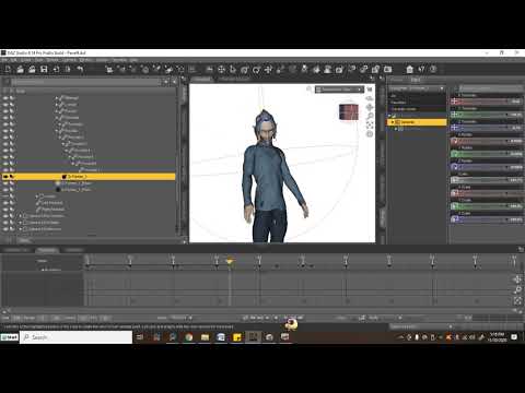

    I finally found a proper tutorial on how to animate parts of the body that are not the breasts or mice tails, no thanks to the lazy PA!
    From this youtube video in the comment section, the guy's name is Crusty:
    GEOMETRY EDITOR
    JOINT EDITOR
    NODE WEIGHT MAP BRUSH
    1 -GEOMETRY EDITOR
    1. Use Polygon Selector Tool to select the area on your figure you want to influence with Spring Dynamics. It will be highlighted.
    2. After you are done create/name your face group...
    3. Options/ Geometry Assignment / Create Face Group From Selected --> Enter a Unique name in the pop up box.
    2- JOINT EDITOR
    1. You will now see your figures bones. Select a bone that is nearest to the face group you just created....then
    2. Right click on bone / Create / Create Child Bone  - - > Enter same name you used for your face group for consistency.
    3. In the <Selection Group> Drop down box select the face group you created earlier to assign to this child bone you just created.
    4. * Use < Rotation Order> to orient your child bone to point towards your face group.
    5. * Use RED and YELLOW arrows to fine tune position and size of your child bone.
    6.   RED= Size
    7.   YELL= Translate
    8. Play around with these until bone is to your liking....Do not let bone poke out of the figure mesh.
    3- NODE WEIGHT MAP BRUSH
    1. You will now see your new bone in parameters tab..select it.
    2. In <Weight Maps> Tab select General Weights under Maps column..
    3. Use Shift P - To paint your weight map over the face group you created....This will assign the bones influence over this part of the figures mesh.
    4. Use Shift S - To smooth the influence of the bones movement over the vertices so as to look more flesh like....
    5. Like everything you will need to tweak until it looks decent....
    6. After all this you will be able to select your bone and move the face group with X Y Z parameters....
    7. You will also be able to influence with Spring Dynamics....
    GOOD LUCK...
    6.   RED= Size
    7.   YELL= Translate
    GOOD LUCK...
    My facebook convo with 3DUniverse:
    Me: Hi, how are you? I had a question about spring dynamics. I'm trying to figure out exactly how to do the jiggly belly in the promo that was supposedly done with d-formers?
    3D Universe: We are great, thanks for asking. For the jiggle belly, we added a d-form to the figure and centered the zone on the stomach area. We placed the center point near his spine, so that the rotation of the affecter created the right kind of belly deformation. We then ran spring dynamics on the affecter.
