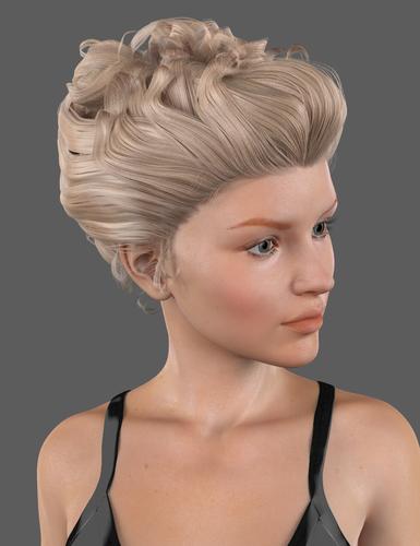

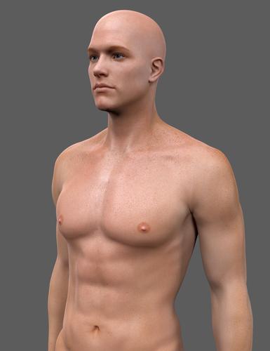

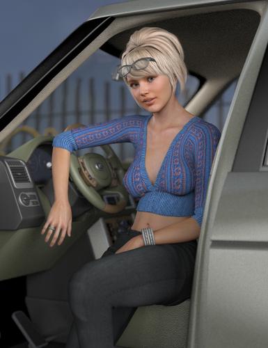

    Hair study. Fine tuning the two geometry shell trick. I've raised the translucence strength so it's about the same as the diffuse. There's still some problems if you view it from inside the shadow's angle, but when viewed from other angles it looks quite good. I really love that rim effect. :) The other problem which is unavoidable is you need to adjust bump strength per hair prop.
    Hair is Goldtassel's Sultry Hair.

  • SpyroRueSpyroRue Posts: 5,020
    You never cease to amaze me Wowie, both your progress in Skin and Hair with UberSurface 2 is so fascinating to see! I love the effect of the translucency of the hair, and the specular looks so genuine, very nice interaction with the rim lighting too I think. The Skin Fresnel seems to work so beautifully in US2, and I really like the specular highlights giving it the final glossy touch. Great stuff :)

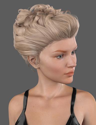

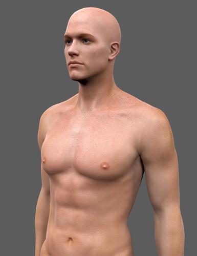

    Probably the best render I've done so far. I enabled OOF in this shot, kept it very narrow so only her torso's in focus. This version took something like 4 min while a larger version 1600x2040 took something like 13 min. Probably should raise the shadow samples a bit mor, particularly for the UberArea lights, but the noise isn't that noticeable in the large render.
    The hair is not using any geometry shell, but the MATs have the updated tweaks. Still looks pretty nice and believable.
    Bigger version at 1600x2080 with UberArea light samples at 128 samples - http://www.daz3d.com/gallery/#images/43305
    800 x 1040 - 560K

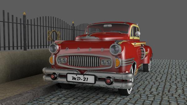

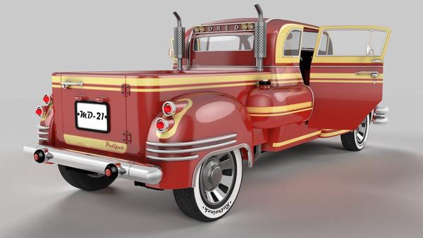

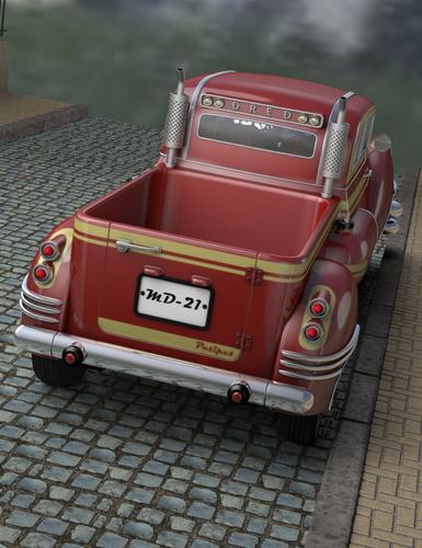

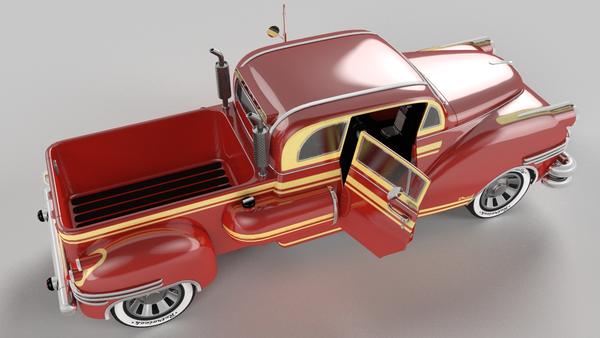

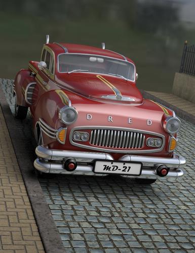

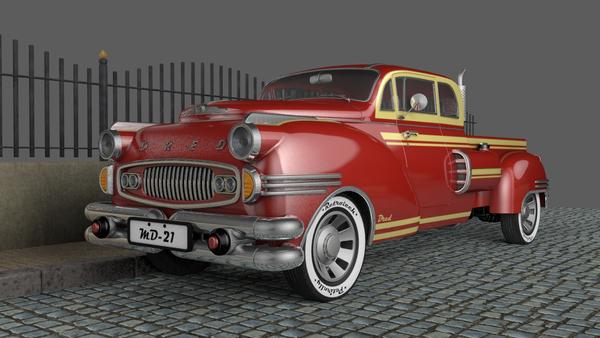

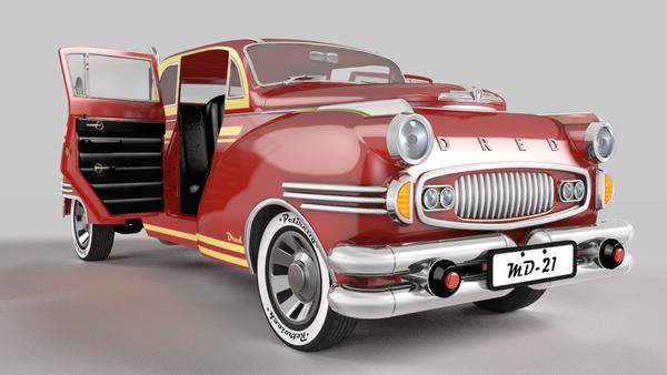

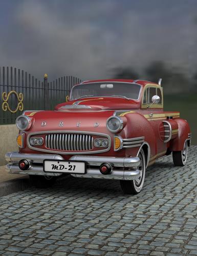

    The metal/base MATs are still WIP though. Here's some more renders with a different car and the light set, rotated to slightly mimic the KH Park HDRI (the image I'm using for the environment sphere for reflections. Pretty happy with the chrome and car paint.
    800 x 1040 - 631K
    800 x 1040 - 607K
    800 x 1040 - 574K
    Post edited by wowie on
  • Mustakettu85Mustakettu85 Posts: 2,915

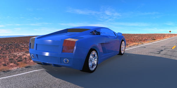

    Hi Wowie, the cars look impressive!
    Have you thought about trying to replicate that "iridescent" sort of car paint that seems to change hue with viewing angle? It probably won't be a 100% believable match without setting up a colour ramp to access based on the angle (so it can't be done in UberSurface, only with a new shader), but I'm thinking an approximation can be done with various colours of specular using different Fresnel attenuations, especially with geometry shells to gain more specular layers.
  • wowiewowie Posts: 1,987
    edited November 2014
    Thanks. :)
    I've found that balancing specular with diffuse and diffuse roughness is essential to getting metal look right. I'm also using both diffuse layers. I've actually made two presets for car paint. The Car Ranger is closer to what you want to do, while the Pickup Dred have a more solid look.
    As you pointed out, the shader needs to be manually written for that. It's certainly doable.If it's angle based, than the easiest way to go is specular with fresnel, with varying specular colors depending on the fresnel ramp/falloff. You probably just need two colors - one to start and another to end.
    You can also hack a solution with a fresnel color (in the same manner). The upside is that you can probably force it to apply to reflections as well. That will work well for metals or even glass.
    Come to think of it, you probably don't need two colors. You can just use the specular color, preferably for the settings when the object/surface is viewed at max angles (specular strength close to 1). The fresnel color is then use to subtract from that color. Again, this can be applied to reflections as well.
    I'm not sure how to go about with the flakes though. Off course, the easiest way is to use a specular map.
    Since you've brought up the geometry shells, I think it's possible to hack a solution with that. Have a geometry shell or two with different specular and fresnel properties and I think if you blend them correctly they can look pretty convincing.

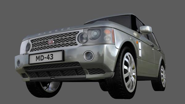

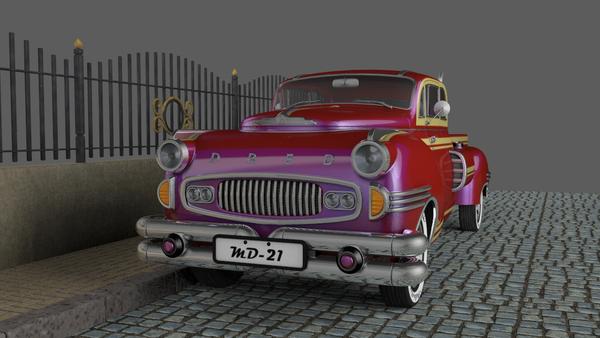

    edit: Below are renders with and without additional geometry shell with different specular and fresnel settings. One problem with this approach is that you need to set opacity quite low and therefor the specular strength needs to be raised to compensate. Plus the specular colors need to be recalculated so you end up with two different colors when viewed at different angles.
    Sorry there's so much noise, This is just a really quick and dry test to see if it's possible. I don't think it looks particularly convincing though. The end result looks more like you have a slightly larger specular coat. So it's not a color shift at different angles.
    1280 x 720 - 549K
    1280 x 720 - 549K
    1280 x 720 - 583K
    1280 x 720 - 586K

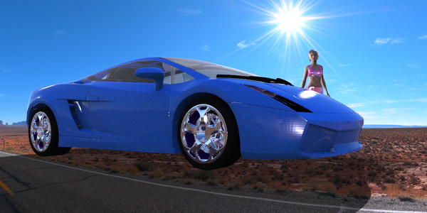

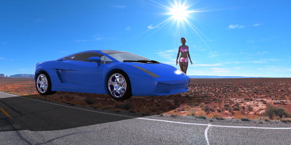

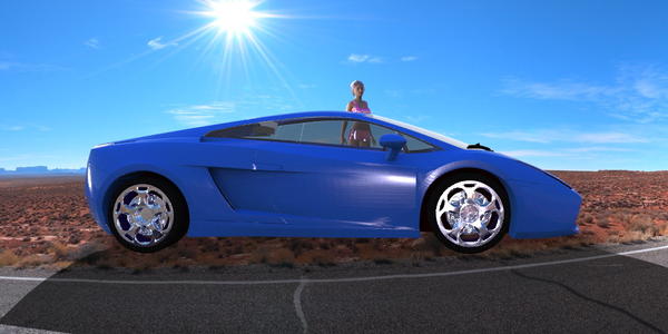

    Been playing around with lights osme more - basically, a fake sun/sky setup.
    800 x 1040 - 312K
    800 x 1040 - 331K
    800 x 1040 - 316K
    Looks nice, maybe you should try adding a bit more of bounce light from the "ground"? The shadow under his chin looks a tad too dark, to me.
    The one with less dark areas already have enough fake bounce lights. I'm rather uncertain to mimic direct sunlight or not. Probably not going to.

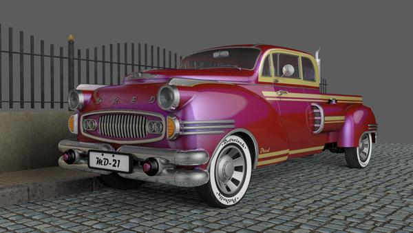

    My take on car paint below. These are quick renders from IPR rendering
    981 x 490 - 155K
    981 x 490 - 153K
    1263 x 631 - 708K
    1263 x 631 - 684K
    787 x 393 - 298K

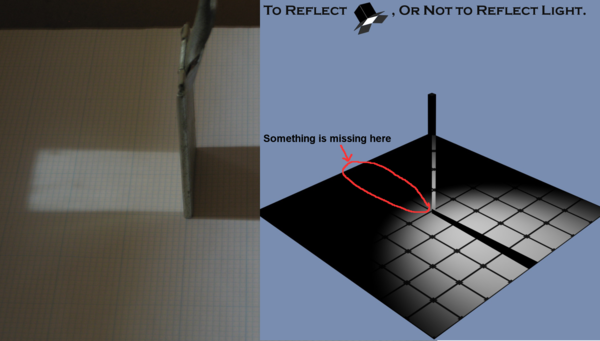

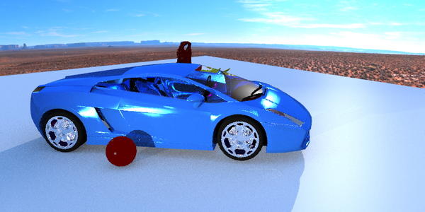

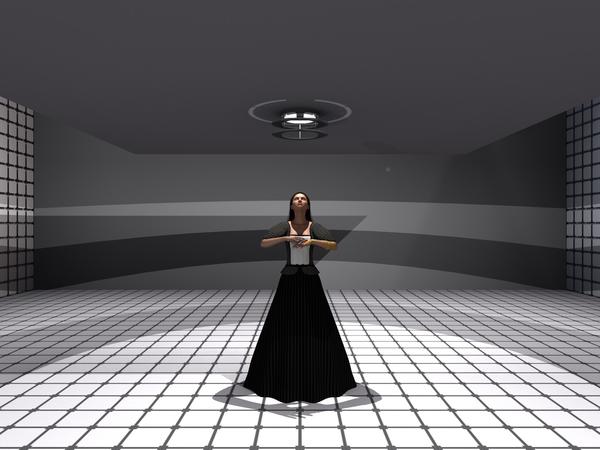

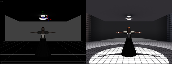

  • ZarconDeeGrissomZarconDeeGrissom Posts: 5,402
    Pleas forgive the intrusion. This has stumped me, and I have yet to find any concrete posts showing how to do this. I took a break the past two weeks, so I have some catching up to do as well.
    A quick note and question. Reflecting “Light sources” not just “Illuminated surfaces”. Daz Default shader with 3delight, is there a switch to make this happen without resorting to Shader-Spaghetti-Magic?
    The light fixture should reflect the light from the point-light back up at the ceiling, making a ring of illuminated-area on the ceiling. I just don't know where that ring of light should be, and wanted the computer to simulate it for me.
    I figured this was to complex, so I simplified it down to a simple Reflective Pillar Test...
    What the “reflective pillar test “ should look like roughly is shown using my stove light, a mechanics mirror, and my clipboard.
    1800 x 1024 - 1M
    1755 x 659 - 293K
    You're looking for caustics. It's an "advanced" feature, default shaders or lights don't support it. If you want "fire-and-forget" caustics, stick to something like LuxRender.
    I tried that Caustics thing, and totally messed up the Demo in the process, lol.
    http://www.daz3d.com/forums/viewreply/702676/
    1, select the chrome Daz Logo, and save it's surface as a "Shader Preset".
    2, load the Pillar test, and apply the new shader to the pillar.
    3, try to adjust the reflective settings to show the plane reflected in the pillar.
    4, go back to the Daz Logo demo to see what I'm doing wrong.
    5, now it is all broken, lol. :red:
    (EDIT)
    Bigger question, assuming I figure out how that demo works. Can Caustics act off of another caustics. Like if I have two chrome rings on that Light fixture?
    1400 x 1050 - 192K
    You need more than just a surface shader for it. Sticking to shader mixer alone, you need a light from shader mixer, and a special shader mixer camera. Sorry about the 'double' there. Is there a laymens explanation for the interaction between the three parts? What is that plane doing? is it a light source of sorts?
    Not sure you can get iridescence with Ubersurface and geometry shell.
    The dark areas should be a lot more darker. SInce the scene is bright daylight, you probably want to limit the intensity of every light but the sun. I've find using an area light and not standard lights works best, since you can vary the size for larger highlights and softer shadows.
    This is most noticeable in the last render. The light opposite the sun shouldn't be illuminating surfaces hat high and the objects cast very visible shadows.

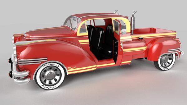

    Almost finished. Still need to tweak the glass and probably the chrome.
    6 Distant light and UE set to BounceGI, with Kettu's script off course. It may not be accurate, but looks very nice indeed. Diffuse and specular bounce needed to be set to at least 4 to get all the refractions from the glass. I've also enabled the raytrace hider in the script. Render time was about 3 minutes with a Core i7 4770K.
    1280 x 720 - 555K
    1280 x 720 - 609K
    1280 x 720 - 566K
    1280 x 720 - 567K
    1280 x 720 - 552K
  • Takeo.KenseiTakeo.Kensei Posts: 1,303
    Was just testing the car paint and IPR render. Very effective and you gain a lot of time for light and material adjustment
    I like your last renders of the car better.
