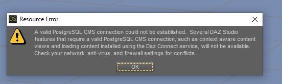

Earlier today, I went to start DS and when I clicked the icon to load, nothing happened and an error popped up. My D drive which has the program was not listed in the system resources in windows explorer. I rebooted and the D drive was again listed. I went about other stuff.
Just a bit ago I  tried to load DS and got the error box ...

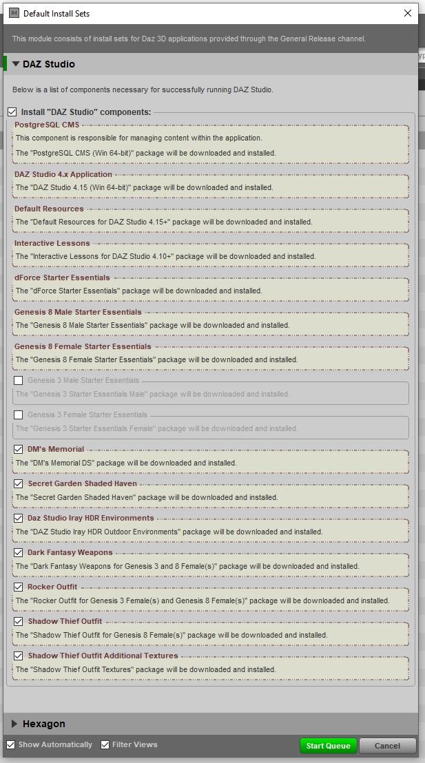

So hmmm ...I then tried DIM ... and a box popped up to install a lot of stuff

  • I got this before. If you open Daz before it properly installs your content, you will get this message. I also noticed that the DIM installer showed content that I already installed yet it shows that I haven't. Forget DIM unless installing content manually. Uninstall products that has errors when trying to load. Reinstall them and check for updates. Check any content that you recently downloaded and installed.

    It is either folder location changed, deleted or due to Daz Studio settings reset. If you can locate installed folder(s) then you need to update Daz Studio settings for content folders.

    Normally starting DAZ Studio, going to the Content Tab, right clicking on the tab there & "Start CMS" (or Restart etcetera etcetera) will do the trick & if not then rebooting.
