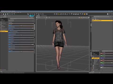

    For making my own billboards, I followed this video and I now have a couple of dozen singles and groups and I am adding to them often. I can understand why someone would buy the crowds avaiable in the store, however - it is a quick procedure to make a single billboard (maybe 5 minutes) but to end up with a crowd might just be worth spending the cash if you have it to spend.
