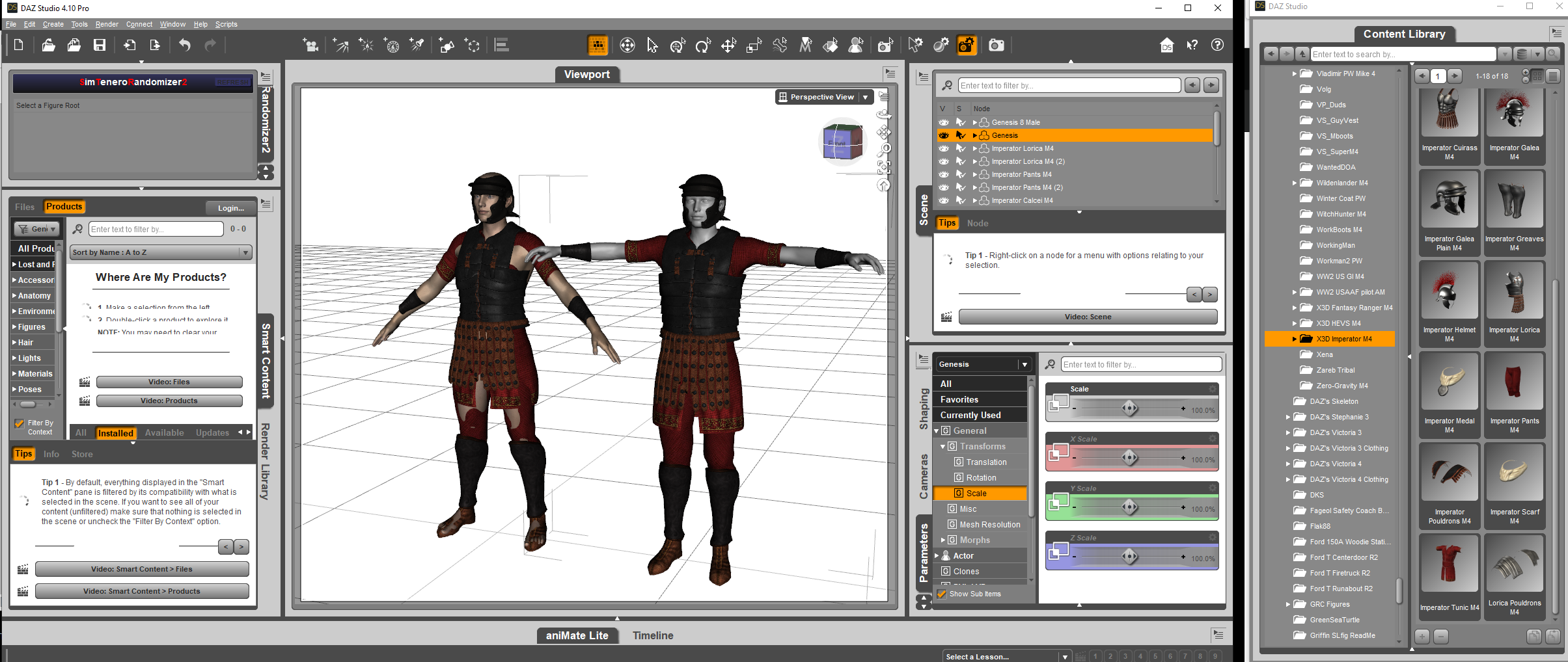

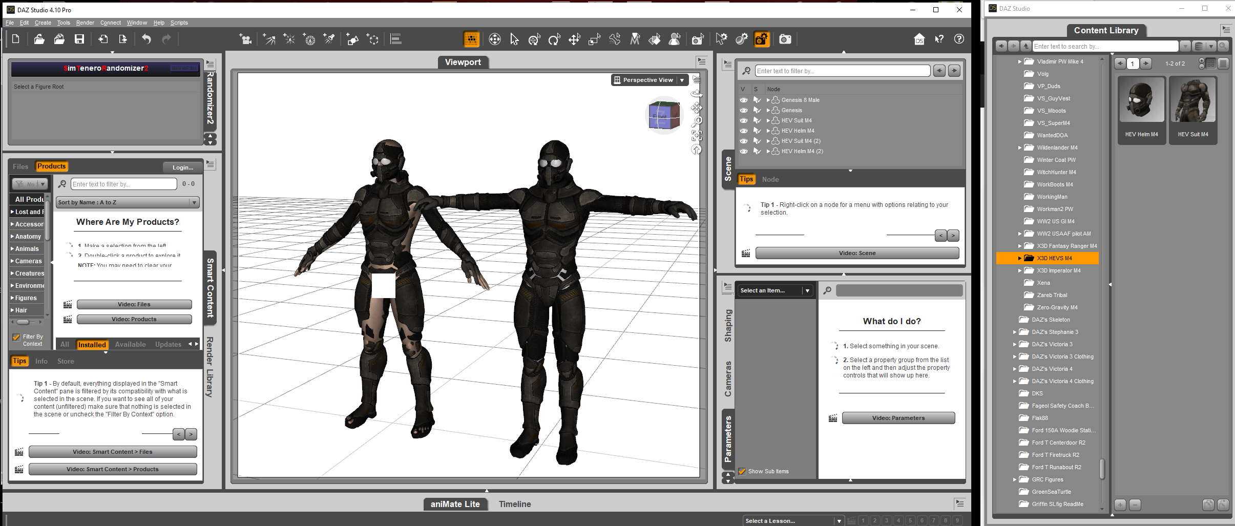

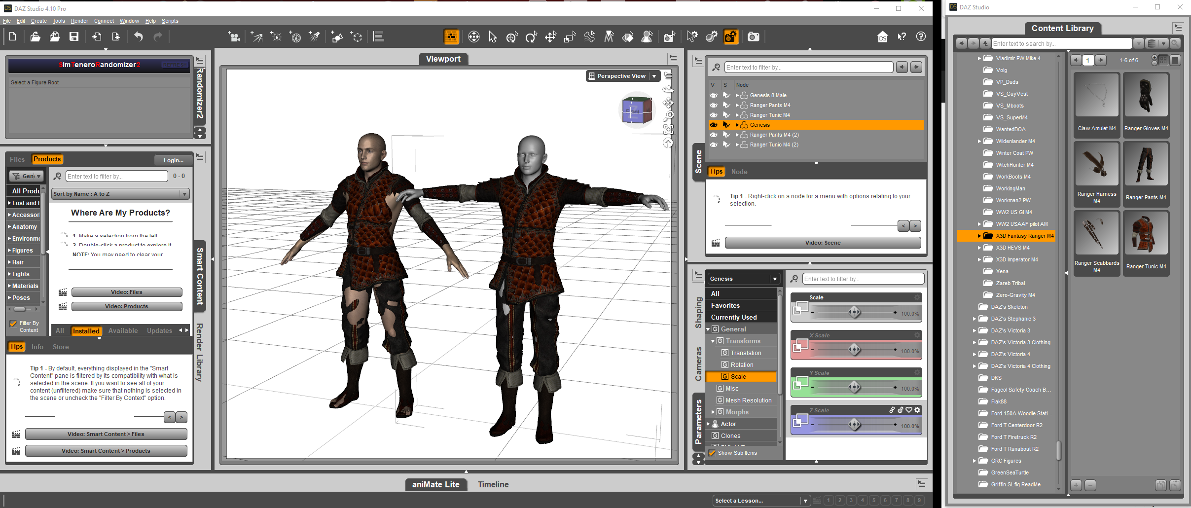

    A few items using Autofit, firstly for Genesis 8 than Genesis
    Fantasy Ranger
    HEVS
    Imperator
    Don't know if Riversoft's item would be better than autofit.....

    Post edited by Bunyip02 on
