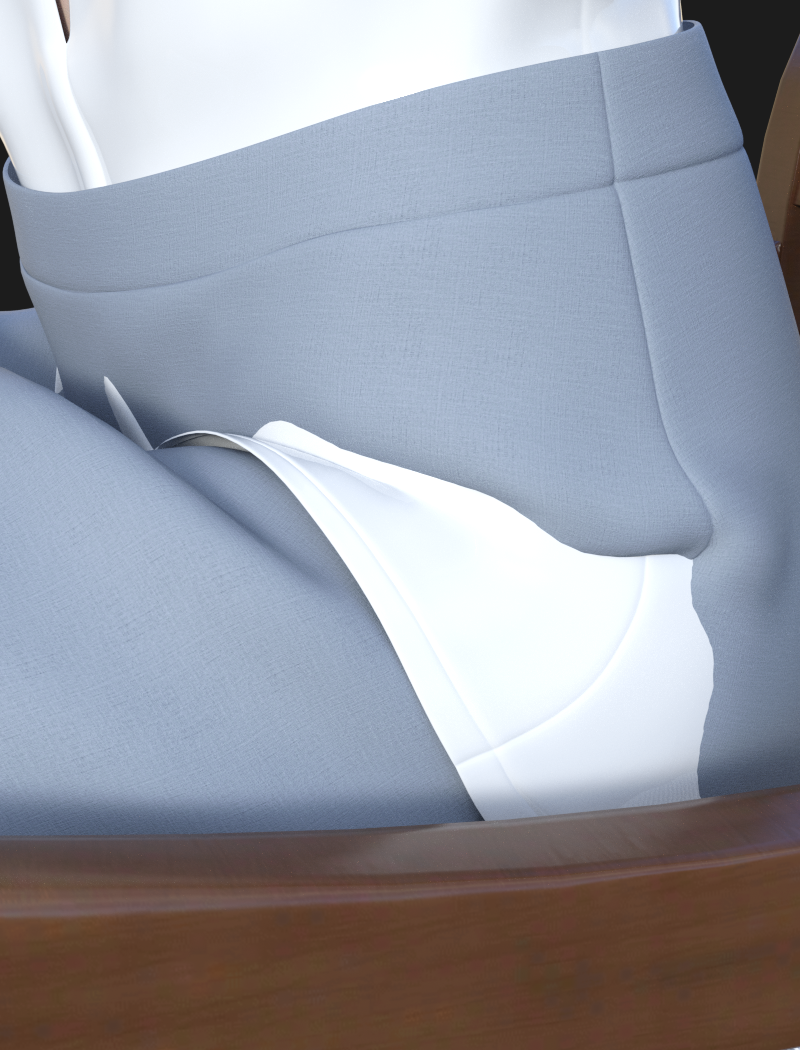

    I did what you said but I dont think it changed my results at all. It just looks like it did before making those changes. I know Im just not doing it correctly.
    Ah, pictures worth thousands, words, etc... This is not your fault at all!! Don't be too hard on yourself and don't give up!
    Most likely the problem is entirely these particular garments being used together... which is silly as they're two of the main components of this set that are supposedly meant to go together. The Skirt has a Dforce Modifier, the Shirt does not. That's not the end of the world, but I'm guessing based on your last pic that you were intending on having the Shirt tucked into the Skirt...
    It looks in your screen, based on the diameter of the Waist/Hip of the Skirt, like you must have done exactly what any sane person would do and with the Skirt selected in the Scene Tab, went to the Parameters Tab and under Formal Mega Wardrobe > Actor > altered Adjust-Abdomen, maybe Adjust-All, maybe even more to try and make the Shirt appear to be entirely inside the Skirt... If so, I'm not sure if you had any more success than I did, but especially while already Posed to be sitting down, I couldn't get the Shirt even close to being entirely inside the Skirt...
    One of the more important things to try and recognize when using Dforce is that before hitting Simulate, you generally have to make sure any Dforce Item that's going to be "draping" (has a Dforce Modifier that's going to simulate) isn't "Intersecting" with anything else. Not another article of Clothing, or a Prop, or even the Figure itself. "Intersection" just meaning one Object's Mesh breaking the plane of another Objects Mesh, like this:
    ^^ This is blatant, massive Intersection. If things looked even remotely like this before hitting Simulate, that's probably entirely the problem.
    A quick test could be (if you haven't already), try hiding the Shirt (and if the Pink that's visible is Underwear, hide that too). Try Simulating and see if the Skirt does anywhere near as poorly as before.
    If so, there may be a few things to look at, if not then you know the problem is just that those Garments weren't designed well enough to Dforce Sim a sitting position at the minimum. You'll notice in the renders I attached, I basically cheated and used a Top that doesn't come anywhere near the Skirt, and didn't use Underwear (I never would unless they were going to be seen for some reason, because they're just another mesh you have to worry about possibly compounding this kind of problem).
    Let us know the results of that test if you're able... Beyond that, it's mainly playing with Sliders in Paramaters Tab > Selected Garment > Actor > to try and fix "Intersections" (which include the most minute "Pokethroughs").
    Also, mention whether you're familiar with Mesh Smoothing and looking at it's related Settings under Parameters Tab > Selected Garment > General > Mesh Smoothing >
    It's completely ok if you're not familiar with that or any of the above, just say so and I'll be happy to lay out whatever's necessary in as crystal clear steps as I can, which I usually do anyway when I try to help someone here, as hopefully anyone else of any level will be able to follow in the future...
    800 x 1050 - 1M
    Post edited by Phatmartino on
