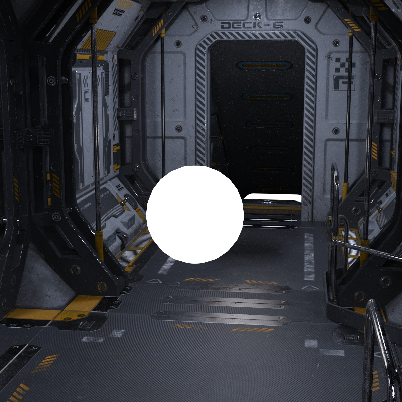

    This is a viewport render of a scene lit by a single emissive light, a 1 meter primitive sphere. Looks fine, renders in seconds.
    PAs can certainly create bad light presets, but emissive/mesh lights work when used properly.

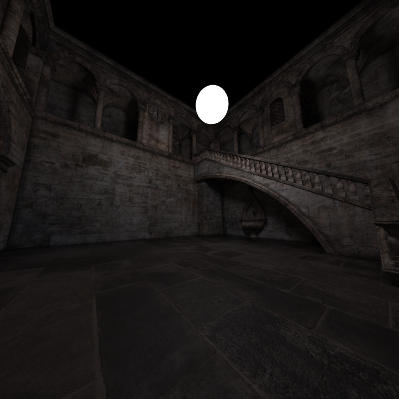

    This first viewport render was done using a point light with its geometry set to 50cm.
    This one was done with a spherical mesh light set to the same size and lumens.
    There's almost no difference. The image isn't any noisier.

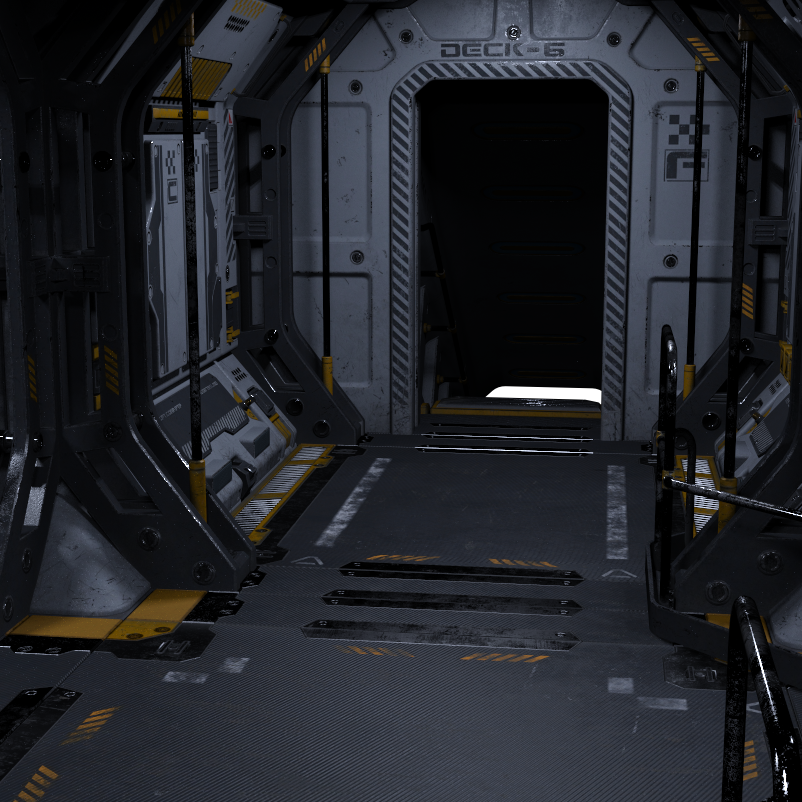

    Now, this viewport render was done with the environment's diagetic lights, the ones built into the ceiling.
    This one shows a lot of noise.
    However, if I set the Max Path length to 2, so the light rays only bounce twice, the problem goes away.
    So it's not necessarily mesh lights that are the problem, but the number of bounces they need to do. I presume since they're on the ceiling, they're not properly positioned to hit all the crevices (as Richard said).
    Now here's the scene with both the diagetic overhead lights and the point light (with the lumens decreased) at the same time.
    Still somewhat noisy, but getting better.
    Finally, here's the overhead lights, the point light, and the mesh light (moved back so it lights up the dark areas).
    It still has some noise, but not nearly as much as the overheads alone.
    So whether you use point lights or mesh lights doesn't matter. What matters is where they're positioned. Blanketing your scene with centralized point lights helps reduce noise created by diagetic mesh lights.
