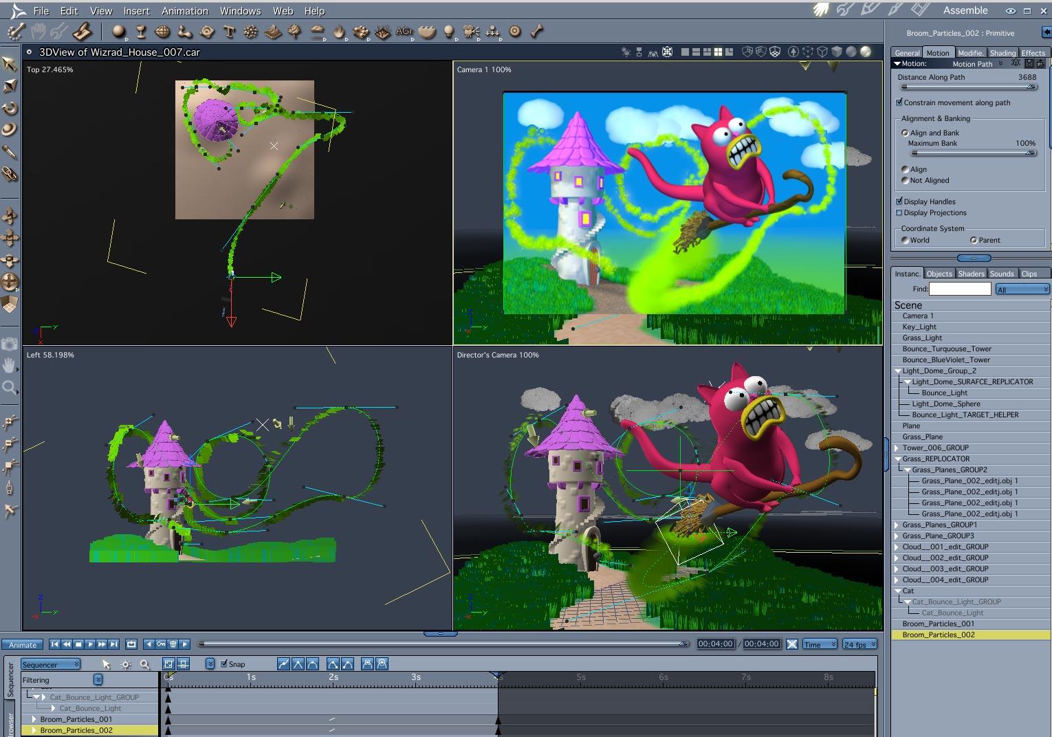

    Thank you Headwax for the extension. smiley
    I made a few changes:
    I added a Particle System and attached it to a Motion Path (Motion Tab > Motion Path). I moved the points of the Motion Path around to create a loopy loopy flight path. I then textured that Particle System with a green 'smoke' texture.
    I duplicated that Particle System and changed a few parameters to create a few 'sparkles' within the green smoke.
    I detailed the broom a bit more to try to give it more character. I gave the cat's tail a morph so it's not so pointed out straight.
    I also added a few more clouds.
    The art you all create here leaves me humbled.

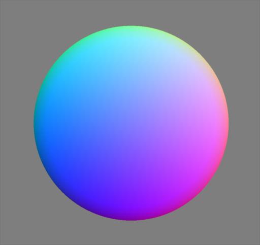

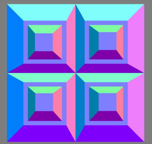

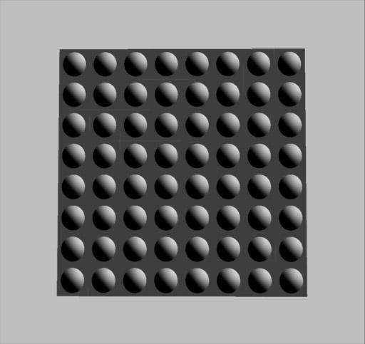

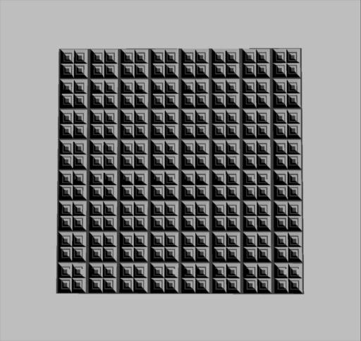

    Here is a quick technqiue to make your own normal maps inside Carrara - no plugins needed (but there are a few caveats, of course).
    I was watching a tutorial on making stylized clouds and in the tutorial the author made a normal map using metaball spheres. I made a similar blob of metaballs and thought I could use the Baker plugin, but I think it requires a UV mapped object - it just crashes Carrara. Converting to a vertex object made a disaster mesh. After a bit of googling around I found this:
    http://www.bencloward.com/tutorials_normal_maps11.shtml
    Skipping down to the part where it says "Creating A Normal Map Right In Your 3D App":
    "Did you know that you can create a normal map in ANY 3D program? You don't need any special plug-ins or exporters or extra tools at all when you create a normal map with this technique! I'll explain how to do it, but first there are a few limitations:
    • Your low res model must be a flat plain.
    • The low res model must have a planar UV projection (flat texture coordinates).
    • You can't use this for characters that have specific unwrapped texture coordinates.
    This technique is really good for environment normal maps like bumpy ground, rock walls, bricks, metal panels, etc."
    Because this technique uses an Isometric Camera, any geometry that is hidden, or undercut from the POV of the camera, won't be rendered and your results won't look right.
    I attached an empty scene with the Lighting set up.
    And here's how:
    Add a Distant Light, Name it 'Green Positive' (or whatever), set to 50%, set color to R=0, G=255, B=0, Turn off Cast Shadows. I changed the Rotation Controller to 'Angles' under Motion Tab > Motion > Rotation Controller. This light is pointing straight down in the scene with X=0 Y=0  Z=0 degrees of rotation.
    Duplicate the light, name it 'Green Negative', and check the Negative checkbox. Leave all other settings the same. Set the rotation to X = 180 so the light is pointing straight up.
    Duplicate the light, name it 'Red Positive',  and uncheck the Negative checkbox. Change the color to R=255, G=0 B=0. Set the rotation to X = -90 Y = 0  Z = 90.
    Duplicate the light, name it 'Red Negative' and check the Negative check box. Set the rotation to X= 90, Y=0  Z = 90.
    Duplicate the light one more time, name it 'Blue'  set it to 100% and uncheck the Negative checkbox. Set the color to R=0 G=0 B=255. Set the rotation to -90.
    Create a new Multi Channel Shader, name it 'White Shader' (or whatever) and set all channels to none. In the Color Channel add a pure white color. In the Glow Channel add a value 0-100% slider and set to 50%.
    Change your object shading to this White Shader.
    Make sure all other lights are off, including Ambient light in your scene.
    Add an Isometric camera and fill your frame however your like.
    If your object doesn't completely fill your frame set the Backdrop to a neutral gray R=128 G=128 B=128
    In the Render room change the Rendering Camera to 'Isometric'
    Render and save in your preferred filed format.
    Now you can use this Normal Map in the Bump Channel of a shader under Bump > Normal Map.
    With this set up I got expected results. You may need to click the Flip X or Flip Y if it looks backwards.
    Also attached is a render of each tiled on a flat plane.
    Edited to add:  Set Blue light to 100%
