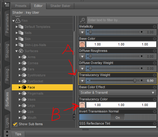

So when i render in iray if a texture ive edited has black on it it turns red and i dont know how to fix it
  • GordigGordig Posts: 10,613
    Might be a translucency issue. Try turning translucency down/off and see if that fixes it. You can also plug your diffuse map into the transparency slot, which you'll probably need to do if that ends up being the cause.

    How do i do that?

    Turn A down to 0. If that solves the problem of black turning to red, plug your modified base color map into slot B and reset translucency weight to where it was before.

  • felisfelis Posts: 5,898
    Select the cgaracter in the scene tab. Open the Surface tab and expand the character till you find Lips and click that. Then you have all the lips parameters to the right.
    Oh, right, you want Lips selected, not Face like in my screenshot.
  • Strobe_LightStrobe_Light Posts: 264
    I ended up doing it for both the face and lips because she has eyeliner on too and it worked!
