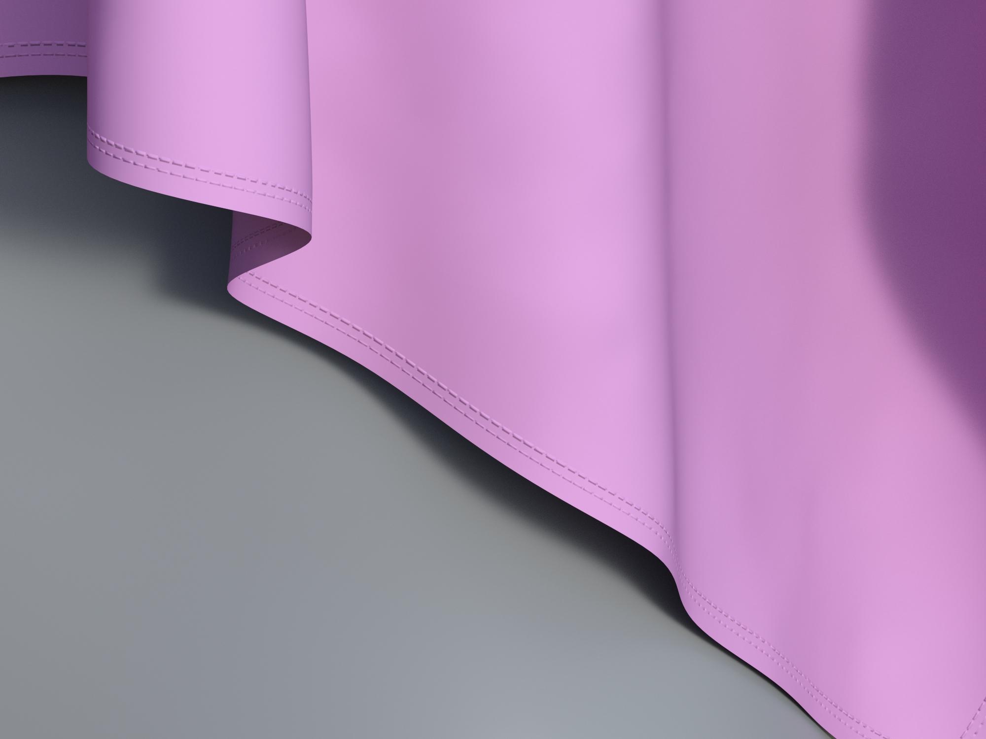

  • barbultbarbult Posts: 27,653
    If I export from MD with Unified UV Coordinates, I get a nice UV, but it has no 3D mesh topstitching on it.
    If I export from MD without Unified UV Coordinates, I get the 3D mesh topstitching, but a strange looking UV (attached above).
    I don't know what to do.
  • Richard HaseltineRichard Haseltine Posts: 111,929
    The UVs for the stitched version shouldn't matter, it's the UVs for the non-stitched version that are getting baked to. Sorry, although I have done some baking to normals it was a while back and not, as I recall, with MD output.
    Thanks for the response. Your help is always very much appreciated I don't see a clear path forward yet, but I will continue to experiment.
    edited June 2021
    I found another video about baking normals in Blender. This one talks about a detailed object and a simple object. The other video created a normal map from the detailed object and said to be sure it was UV mapped. There was no separate simple object in that workflow. I'll try this new one and see what happens.
    And here's another video that goes a lot slower with more discussion.
    Post edited by barbult on
    Ah, bad pick of video on my part then - baking to another, simpler mesh was what was intended.
    edited June 2021
    Your later post about "detailed to simple" gave me the clue I needed to figure out why it didn't work. The Blender Guru video  was what I needed in the end. It worked! Here is the normal map applied to my simple mesh in Daz Studio. '
    Now, I need to know how to combine normal maps so I can layer this topstitching normal on top of the fabric texture normal generated by MD. Any ideas to point me down the right path?
    2000 x 1500 - 1M

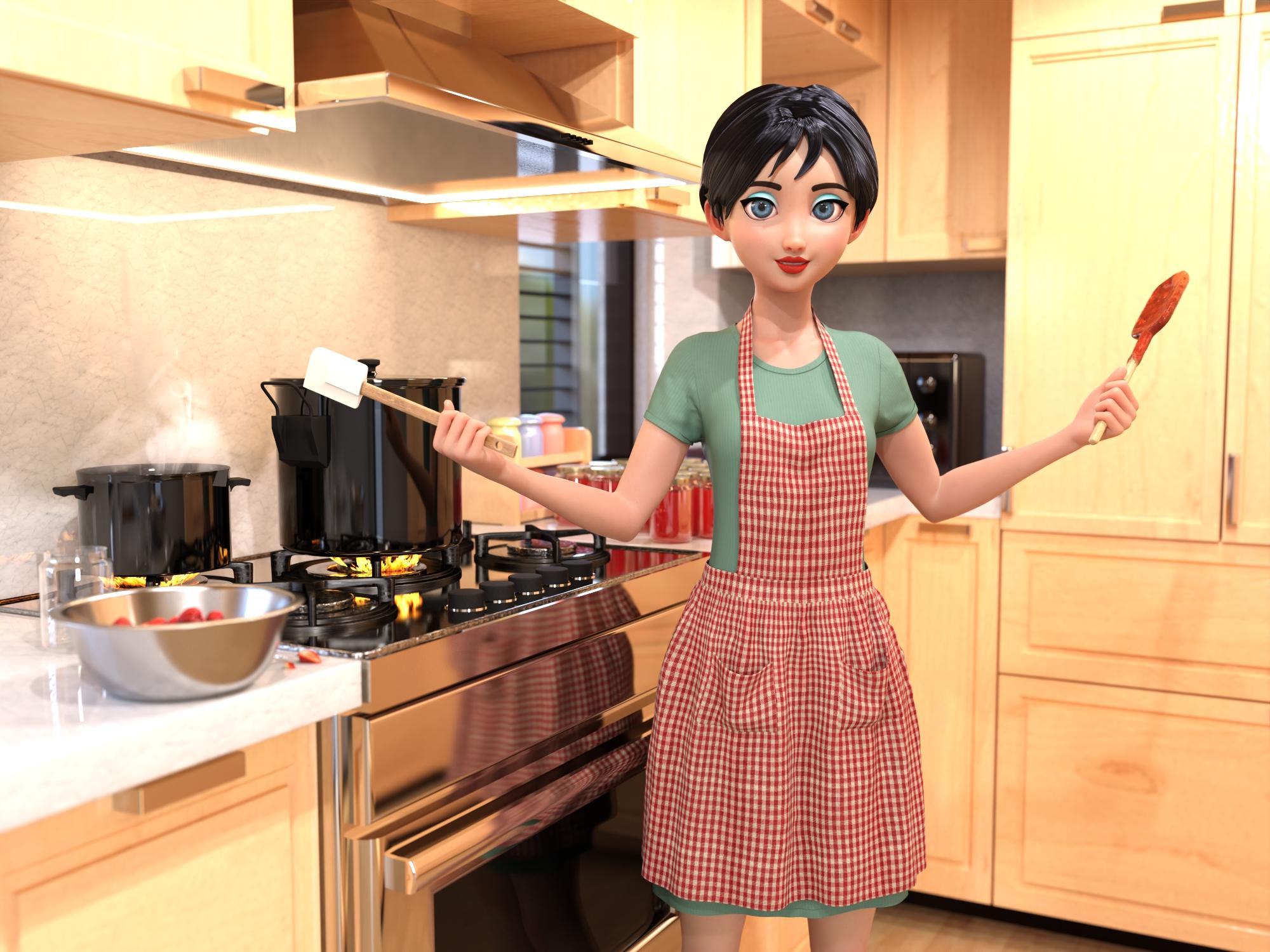

    This is a simple dress and apron I made in MD 11. I used the Thickener plugin after posing and dForce was done.
    Making Strawberry Jelly
