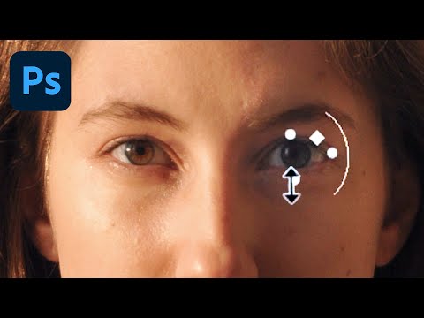

    If you are doing post work in Photoshop you might find this helpful.
