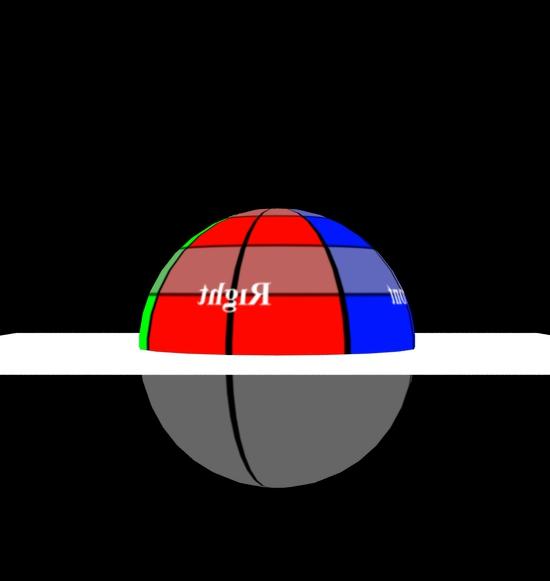

Sphere correction
As already explained in other comments and posts, the sphere has the wrong UV and it is also rotated on the Y axis.
My advice would be to delete it and replace it with a correct sphere. In any case it is possible to solve the problem by proceeding in this way
Show hidden properties
Unparent EnviromentSphere
Unlock Y Rotate
Unlock X Scale
Set X scale to -100 (This way we avoid having to flip all the images we want to use.)
Now we need to rotate the sphere on the Y axis
Set Y rotate to 108
The sphere is now in the correct position
