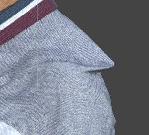

I am using the following product:
https://www.daz3d.com/dforce-mi-casual-outfit-for-genesis-8-males
I am getting a strange effect with the shoulders, and I can't figure out why.
This happens when I add it to the character. Nothing in the parameters seems to adjust it.
After running a simulation the shoulder looks like this:
The character is fairly thin, does anyone know what could be done here?
  • FSMCDesignsFSMCDesigns Posts: 12,855
    it's usually down to the morphs used in the figure. I just checked it out myself and the lithe morph causes this also on my end. Either don't use the lithe morph or put in a support ticket to get it fixed. really sad that it has been out for awhile and noone has seemed to have reported this.

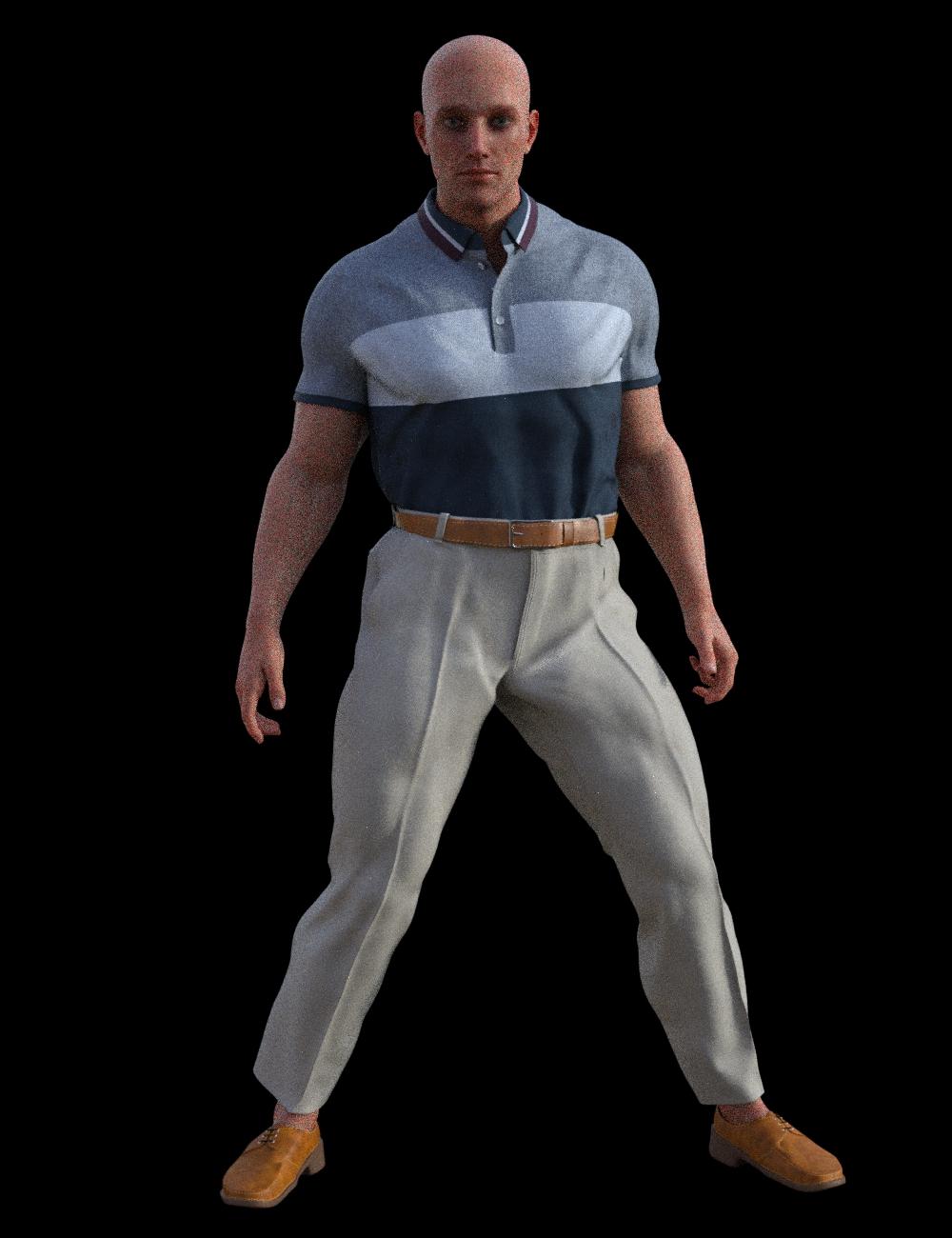

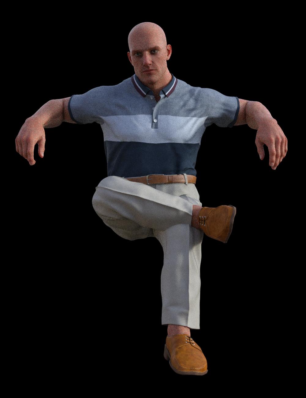

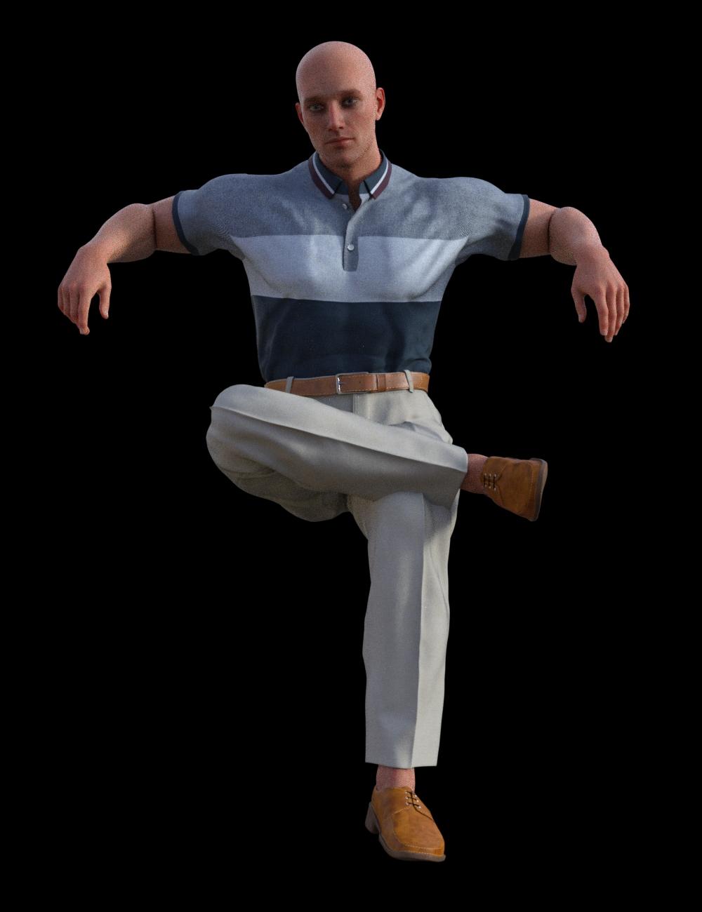

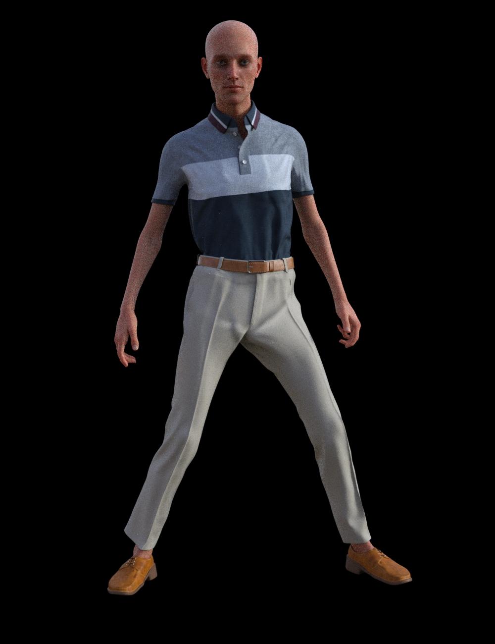

    I'm very sorry that you're having issues with my product.  Like Richard said Rigidity is causing the weird issue that you are seeing in your posted pic. I see the flaws in my first product and had made those changes in regards to the problematic shoulder and the waist area.  The problem should be no more after the fix is applied.  See the below for reference.  I will try and get the change applied as soon as possible as I been busy with IRL and trying to get my next product out.  I'm sorry for the inconvenience this has caused you.
    Not sure what thin character you used, but I posted an example below with: Body Size -100%, Weight -100%, Emaciated 100%
    No dForce used.  Some minor adjustment will still need to be in use as per Rigidity's nature.
    Dwarf Morph 100%
    Body Size 100%

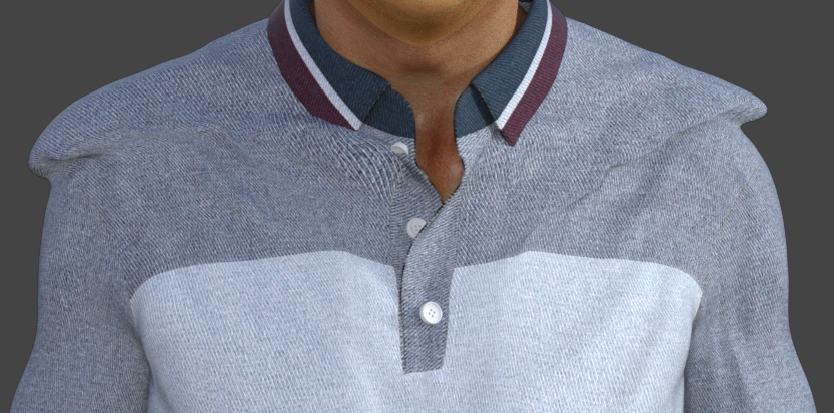

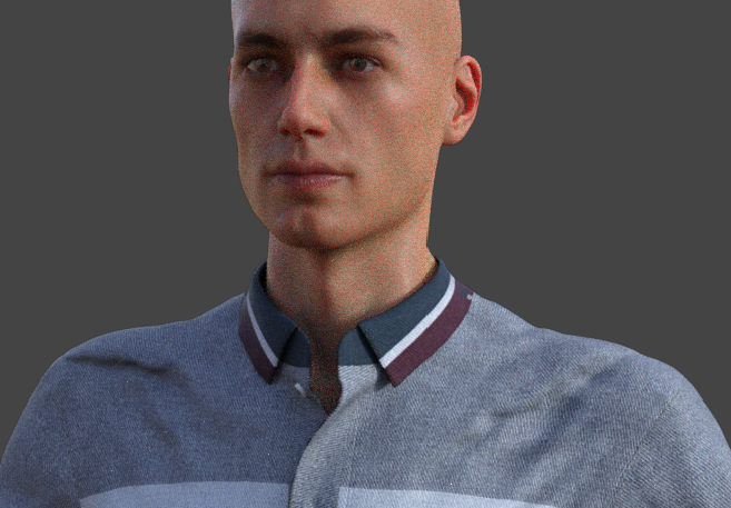

    Here is Michael 8, with only the Thin morph, 100%, nothing else.
    I haven't tried emaciated yet. So you shouldn't need Mr. Wu or Owen that were in the images I sent in the message.
    But just putting it on Michael 8 caused this:
    No morphs applied here.
    Anyway, thanks for addressing this issue. I'll keep an eye open for the update.

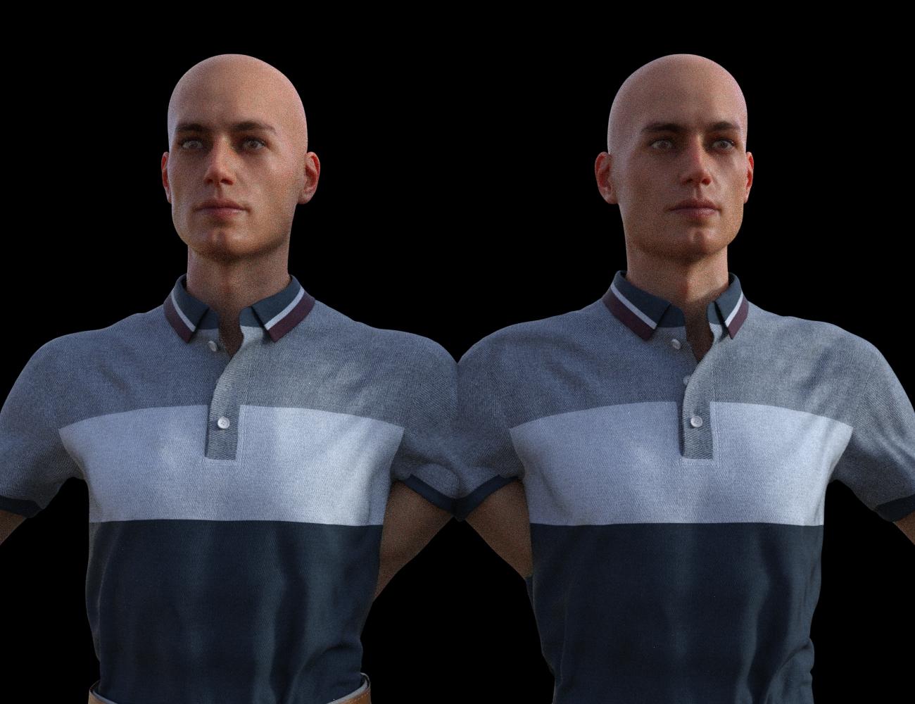

  • mal3Imagerymal3Imagery Posts: 722
    edited April 2021

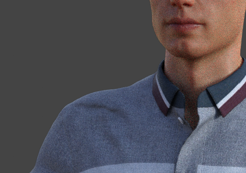

    TheMageWilliam said:
    Here's a side compare of Michael with Thin Morph.  You won't get a more refine look on the collar now, since I lessen Rigitiy, but should remove the shoulder pad look. (From Left (new) to Right(old) with default settings).
    I always recommend using smoothing iterations values between 5-15 on anything clothing related for a more refine finish look.  That's why DAZ has it there :)
    You can use it for the time being to help with the issue before the changes becomes live.  See below.
