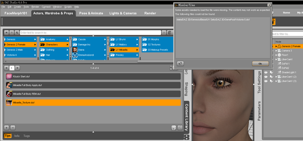

I get this error, every time I try to load the figures mentioned into a scene, or call up a saved scene with them in it. It is not detrimental to the figures, it is just annoying as all (Pick a Random word, lol).
This error happens when loading the 'Texture.duf' for both figures.

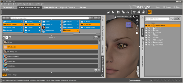

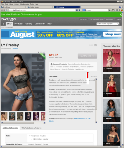

    Now I'm confused, because they are in the G2F path, the requirements are the G2F morphs, and they are both sold as G2F figures.
    1442 x 686 - 53K
  • jestmartjestmart Posts: 4,449
    Based of the product page they contain both Genesis 1 Classic (G1C, my own made up designation) and G2F settings. The vendor may have taken a shortcut and just cut and pasted the G1C preset in to the G2F folder, in which case it should be reported.

    Thank you HeraldOfFire and mark128. Sometime in my absence, it looks like the V5 requirement was added to Mikaella, tho for the text "Use with Genesis requires Victoria 5" had me thinking I was all set with sticking with G2F stuff.
    LY Presley also requires Aiko6, that almost was invisible in the list of requirements for that figure. Thankfully I did get Aiko6, so that was not an issue.
    I have no desire to spend in excess of forty USD for V5, especially considering already got the V4.2 god-bundle, and V6.
    I will contact daz, tho I'm not expecting much as both figures now explicitly state the V5 requirement.

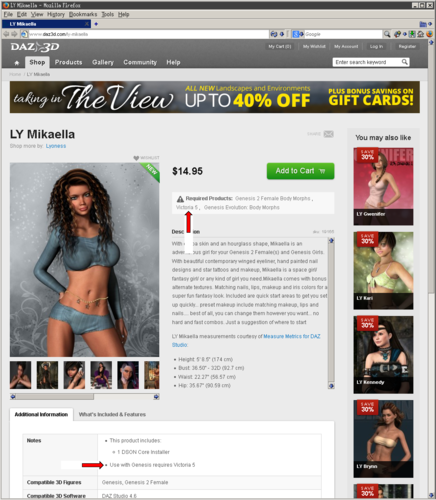

    It says on the Product Page :
    •Use with Genesis requires Victoria 5

    At least Mikaella's page has been updated to reflect the V5 requirement, tho it now implies like Presley, that V5 is only required for use on Genesis and not G2F. This is truly deceptive, at best.

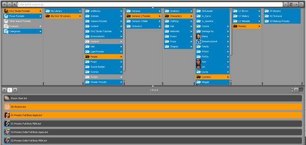

    Is that save thing something that can be done in Studio, to fix the "00-Texture.duf", or even add one to the folder?
    Is that the default G2F eye??? I don't know.
    1395 x 649 - 145K
    1534 x 695 - 220K

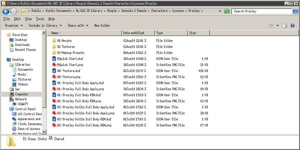

    that "!!Quick Start.duf" dose not appear to do anything, what is it?
    (EDIT)
    I think I found the files, Windows 7 dose not put stuff in logical places, lol.
    1091 x 546 - 48K

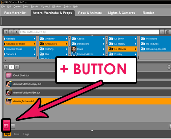

    If you want save a material preset (which is what skin textures are) you can use the little + button in the preview area of the content library. it's at the very bottom. See picture.
    first select genesis 2
    click + button
    select Material preset
    pick the texture that you are going to replace and click
    if you are replacing the main texture... do not unclick anything in the options menu and click
    and voila... you've saved it!
    343 x 279 - 45K
