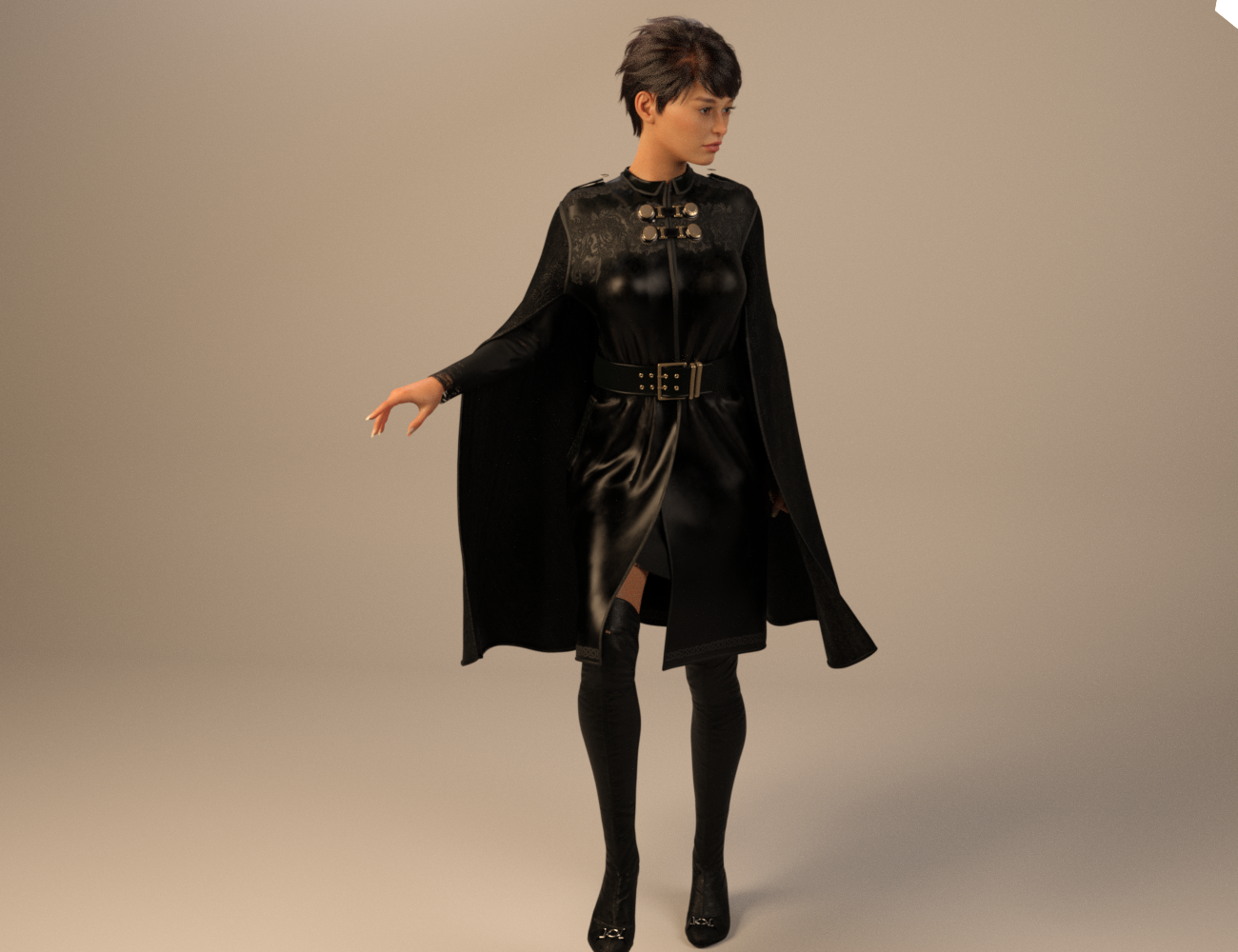

    I loaded MRB all, and that doesn't load the 'smooth' versions. Then found a pose and simulated along timeline.
    The material has an issue as they expect a G8.1 character.
    There is a number of distance violations, i.e. edge lenght shorter than collision distance. I didn't investigate where they were. It might be in areas where there is no simulation weight and then it don't matter.
    1300 x 1000 - 2M
