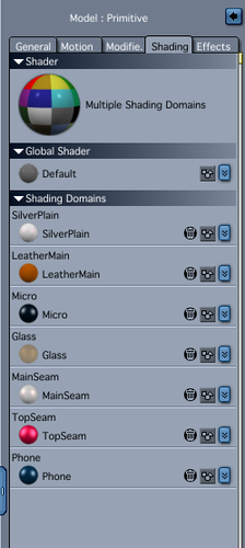

    I just looked at the shading domain structure of Michael 4, which is a single model made up of multiple shading domains. When first loaded, M4 consists of a group with a model and a hip. The group level has a shader. The model starts with the group level shader as its top shader, but that shader is not applied to any of the shading domains. Each shading domain is assigned one of the maps (limbs, ....) corresponding to a uvmap of the M4 model. The bone structure component of the M4 group doesn't matter for shader questions. Quickly confirmed that changing the shader domain at the M4 group level and using "apply to children" merely changes the top shader of the M4 model and does not change any of the shaders applied to the shading domains. Similarly, changing the top shader in the model level to a complex layer list will not be applied to any of the shading domains. If try dragging and dropping a new complex layer list from the top level to the individual shading domains, it replaces the current shader, it does not apply a complex layer list with the current domain shader as one of the layers.
    Does the following restate the question? Is there a way to convert the top level shader of a model to a complex layer list, which then could apply the new shader to each shading domain of the model, yet preserve that shading domain's current shader as one of the layers in the layer list (appropriately designated by an opacity mask that matches the shading domain)?
    That would be great. I hope so. Maybe 3DAge or Ringo or one of the other super-experts knows of a way. But, I don't think so. I don't think it is a limitation of Carrara, because Carrara's shaders can be set up to do this. Instead, it is a limitation of how the current shader of M4 and other standard content is assigned.

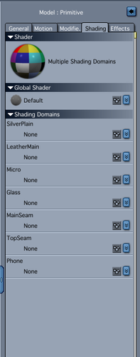

    So let's say I have a pair of shoes that has 5 shading domains. In my choices of what color I want the shoes to be I can choose, say, the green shoes. I click the picture of the green shoes with the shoes selected and apply that matte.
    Now, once I go into the shoes and create a complex shader for each shading domain, I'd like to be able to click on, say, the pink shoes and apply that to a second layer in the complex shader.
    But thus far that has not been able to be my workflow. I have to create individual shaders by hand for each shading domain and then construct accordingly. It's just super inefficient.

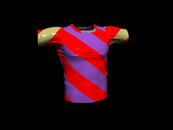

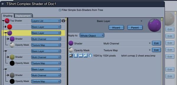

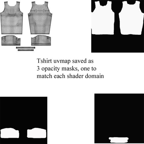

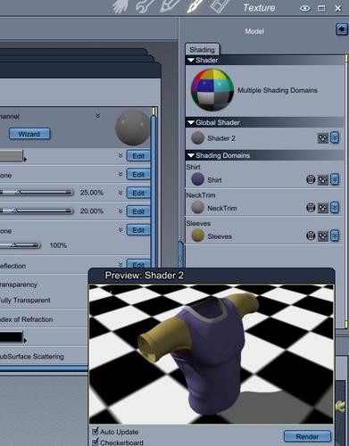

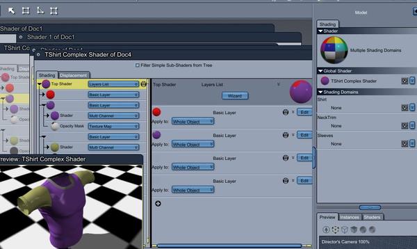

    Here it is, illustrated with the M4 basicwear tshirt. The default load has one default shader at the top level, but each shader domain with a different shader. There are only three shader domains so I will illustrate how to turn this into a single shader, with an opacity mask corresponding to each shader domain, that can then be saved to the shader browser, adjusted with a new layer, mixer, or what have you.
    1 - the M4 basicwear tshirt comes with a template uvmap. It is easy to identify which parts of the uvmap correspond to each shader domain. In photoshop, I made and saved 3 different opacity maps - one for each shader domain.

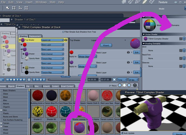

    2 - In Carrara, I created a shader, using complex layer list, that mimics the default tshirt shader. You know, with the awful purplish, khaki-ish, and grayish colors. The single complex shader simply consists of basic layers (multichannel) with its color.
    3 - I placed the new complex shader at the top level and in each shading domain. Now, if I change that single shader, it will be applied to each shading domain.
    4 - I saved that shader to my browser for future use.

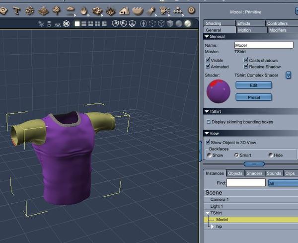

    5 - To illustrate, I created a new layer, picked bright red for no apparent reason, then assigned the caution pattern as an opacity mask. You could be more precise by creating the opacity mask with the 3D paint tool, but this is just for illustration. The red is applied to each shading domain, but each domain's original shader is also still there.
    - Carrara can do this. The limitation comes from the way the default shaders are created, but you can overcome it. For single uses, it is probably not worth it. For models that are used often, it might be worth it.

  • DiomedeDiomede Posts: 15,464
    edited July 2014
    and here is a new file, with the tshirt loaded again. I simply dragged the shader that I had saved from my browser to the the top level of tshirt shader (that looks like a sphere). Carrara applied that single shader to each shader domain (see how they look empty). Yet, each shader domain still looks similar to the default 3-color load.
    Edit - it occurs to me that there is more than one thing that looks like a sphere. Highlight the tshirt "model" within its group and enter the shader room. Drag the complex shader that you save to your browser to the top globe that says multiple shading domains. I've added another pic to illustrate.
    963 x 702 - 399K
    951 x 567 - 92K
    708 x 577 - 66K

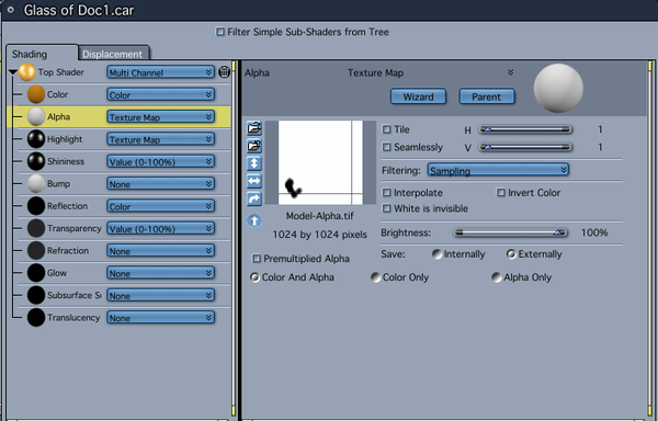

    3D paint can be a little tricky to use sometimes. I usually just stick the default shader on my model across all domains (after I save the original multi-domain shader to my browser), and then when I get the warning about how I don't have a shader selected, blah, blah, I click okay, go to the list of shader options, choose what I want, such as alpha, and choose the create a new shader option. The dialogue pops up where I can choose the domain, the resolution, the background color, etc. I make my choices, click okay, choose my location, format and name it, then I click save. I then begin the painting process. When I'm done, I exit the paint function and save my scene so that Carrara writes the paint data to the image map I saved earlier in the process. I then reload the original shaders from the browser, open the domain I want and the shader channel, such as alpha, and select image map from the pulldown menu (if it's not already selected) and load the image map I had just created.
    246 x 183 - 14K
    405 x 136 - 18K
    253 x 641 - 34K
    245 x 217 - 24K
    249 x 556 - 41K

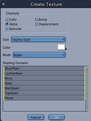

    Screen shots Continued:
    708 x 453 - 86K
    294 x 393 - 27K
    409 x 142 - 13K

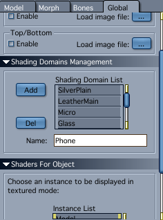

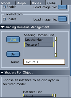

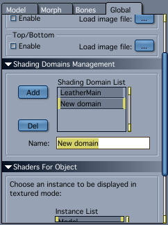

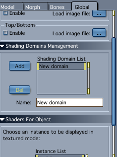

    To go back to your question about getting rid of shading domains, you can do it, or define new ones without having to delete old ones. Don't know if this will work on Genesis or other triax figures.
    1) Select the model, open it in the vertex modeler.
    2) Select the Global Tab. You should see a list of domain names.
    3) Select the domains and press the Del (delete) key to delete them. You can delete all of them except one.
    4) If you want one domain for the entire model, highlight all the polys on the model.
    5) Click Add Domain. A dialogue will pop up asking if you want to use the selected polys as a new domain. Click Okay .
    6) You should see new domain that says Texture. Select it, and rename it if you wish. You can now delete the last original domain and your new domain will cover the entire model.

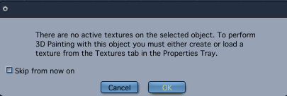

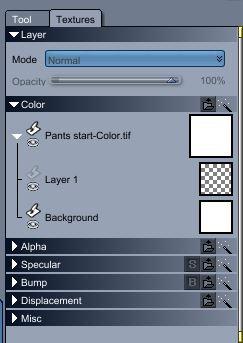

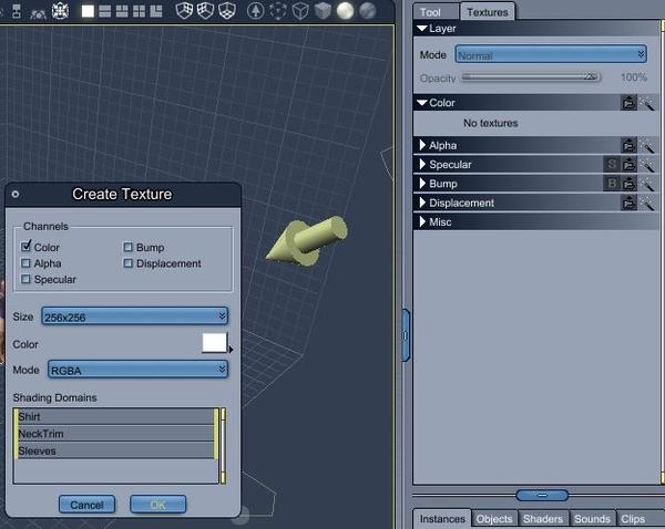

    Regarding the 3D paint tool. Yes, it has a layers function. In the 3D paint tool, open the channel that you plan to work on (color, alpha, specular,...). If you have an underlying texture map, click on the folder and load it, if it isn't loaded already. Right click on it and save it under a new name (like whatever2). Click on the folder again and load (whatever2). That is just to make sure you don't screw up your content. Right click again and choose "add layer." Make sure the little paint sumbol is highlighted so the layer is the active paint region. Paint on the layer as you wish. Add more layers. Paint some more in each. Save whatever2 for use in your mixers.
    Something to watch for - the 3D paint tool and the uvmapping (if any) work closely together. If the uvmap has overlapping vertexes then it may screw up your 3D painting.
    In extreme circumstances you can save your object under another name (whateverobject2), then create an entirely new uvmap for it. For a complex object with a lot of shader domains, thisn is a pain in the patuska, though. Any existing templates and maps are likely to be useless for whateverobject2, although they would still be fine for the original content.

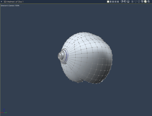

    Just to put everything in exact context for what I'm trying to accomplish:
    I'm trying to paint on one of these helmets http://www.daz3d.com/sedition-soldier-for-v4
    This helmet has five shading domains. If I start painting on, say, the bottom rim of the helmet, the paint show up there, but it also shows up on another portion of the rim where I'm not painting.
    So basically I need to 1) figure out how to stop that from happening (which might involve the uvmapping issue you're talking about) and 2) I need to be able to do it TWICE on the same model. That is, after I create a Multi Channel Mixer for the shader, (which essentially works out to be two identical textures atop one another), I need to either be able to paint on it again on the second texture, or I need to be able to save the painted texture and apply it to the underneath texture.
    Is that possible? Can you paint something and save the painted thing as a texture? In this scenario, I don't see how since there are 5 separate shading domains. The only thing you can do is apply a global shader which does me no good because I'd need a global shader for each layer of the Multi Channel Mixer...which is not how global shaders work. They don't work as individual textures. You can create layers in the global shader, but those layers have no real functionality other than just being layers.
    One *possible* workaround...if I could paint each section of the helmet in parts and then save each of those shaders separately? I think that would work. But again, it comes down to -- can I save a painted shader as a texture map?
    *If* I can save a painted shader as a texture map and *if* I can paint on the bottom rim of the helmet without the paint showing up at the top of the helmet, then that would solve the issue. But I don't know if either of those are possible -- especially since we're talking about 5 different shading domains. Like, can I paint just parts of the rim of the helmet and save that as a texture and then apply that texture while still being able to apply other textures?
    Just seems impossible with Carrara. If I was using a normal workflow that didn't involve the Multi Channel Mixer it might be more feasible (I'd just need to figure out how to overcome 3D Paint painting where I'm not painting), but being that I'd need whatever I paint to be saved as a texture map for a global shader...but then would need two global shaders (which isn't possible).

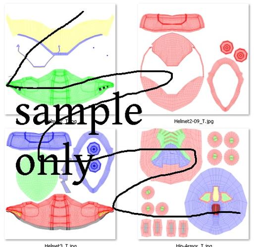

  • WendyLuvsCatzWendyLuvsCatz Posts: 41,678
    the UV mapping determines where the paint goes
    if UV's overlap paint appears in both places
    I looked at template seems overlap
    need a seperate texture for each one
    563 x 544 - 108K
    And what you posted there -- that's not a texture map, right? Like...is there any way for me to use what you have there as a guide in photoshop? Because that would be amazeballs and would solve everything.
    Is there a way to make a texture map with what you have there (and I've no idea where you even got it haha)

  • BC RiceBC Rice Posts: 591
    BC rice that exe is a texture template the one I posted
    it is a map you can open in photoshop or gimp or something of the models UV"S
    which are 2D cartesian co-ordinates for X,Y axis as shown if you unfolded the model to a flat sheet
    you use it as a guide to paint textures in 2D
    Thanks
    Again, totally outside my normal comfort zone. But something good to learn! :)
    So I guess I should...like, take the map there, color one thing whatever way I want it colored, and then make the rest of the surrounding area white, and then repeat the process for each shading domain? That seems logical at least. It's still going to be a pain in the butt to try and line things up across shading domains, but at least I'm not flying TOTALLY blind with having this guide.
    We'll see how it all turns out. haha
    Any advice anyone has about making art line up across shading domains would be cool.
    Thanks for all the amazing help here! Always my favorite community of artists!! :)
