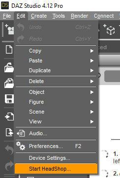

     1. It sounds like you may have missed putting the figure to base resolution. And yes for the G8 figures, no eyelashes.
    For the Windows edition, yes when you open D/S, under Edit there should be the option to start Headshop. Check through the provided readme instructions for installation.

  • I followed the directions and manually installed but it is not appearing on the edit drop down. Anyone else had this trouble and found a workaround/solution?
    99% of this situation user installed HeadShop to default installation, but has the working DAZ Studio on another location.
    Step 1. Make sure you verify where your working DAZ Styudio is installed.
    Step 2. Once verified, install HeadShop TO THIS LOCATION. For example: if your DAZ Studio is installed on d: Apps/DAZ 3D then you enter this as the destination folder at install.

  • Update on my installation difficulty Headshop: Predictably the problem was the way I had Daz set up as I had tried to move its location in the past. Lasloves (the author) emailed me the day after I posted to the forums. Unfortunately, the email got caught in a spam folder. He then contacted me on the forums (which prompted me to check my email spam folder). We set up a time to skype. He solved my problem in 8 minutes and 3 seconds including introduction and pleasantries. To say this was great customer service would be an understatement. I am now up, running and completely recommend headshop 13. Also, I feel completely comfortable purchasing anything produced by Abalone LLC. Thank you again!

    I am also having a problem installing HeadShop 13. What I have tried:
    • Gone to Help/About Installed plugins" and click on any plugin. Where I read the location where the DAZ 3D/DAZStudio4 folder is installed. Then followed the directions in the YouTube video to manually install.
    • Clicked on the Install Manager Ready button on the product page. Then finished in DIM.
    After each attempt I restarted DS.
    Would you be able to list the process you used to get it working?
    Thanks
  • mbKingWin, HeadShop DOES NOT INSTALL WITH DAZ INSTALLERS!!! It has its own installer. Please read README document that explains the installation.
    The installer has step by step instructions. Key is to select the CORRECT DESTINATION FOLDER to install to.
    The steps outlined to find where your working DAZ Studio is installed are in the manual in Chapter 4: https://printahead.net/wp-content/uploads/2020/05/HS13-Manual.pdf
    If still no luck, pls. send me an email: [email protected]

    That seems to have fixed it.  So, it appears that there are two application folders, One at C:\Daz 3D, and onother one inside that folder at C:\Daz 3D\Applications\64-bit\DAZ 3D, That just seems wrong!
    Anyway, It was the nested one that I needed to use for the install of HeadShop.
    Thanks for the help.

  • mbKingWin, you are right, one of the folders is wrong, due to inattintive installation. Please readREADME before installing!
