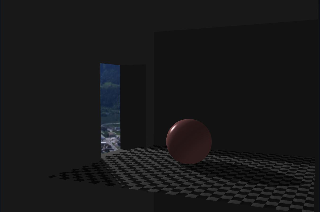

  • DiomedeDiomede Posts: 15,398
    edited January 2021
    Great job, everyone.

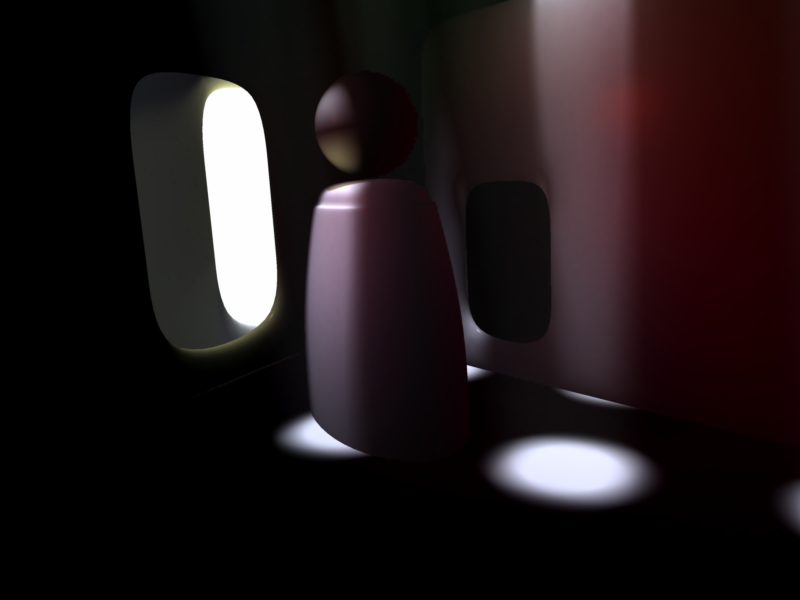

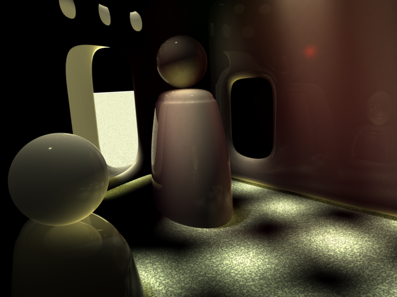

    I am still frustrated trying to get the light stream effect following the Mark Bremmer tutorial.
    I created the transparency box as per the tutotial.  I made a wall with a window.  I placed a box on a floor plane.  I placed lights outside the wall and pointed through the window.  I placed my camera outside the transparency box.  I render settings, I have indirect light and light through transparency checked.
    - Very strange result.  Window shaped light artifacts follow the light direction.
    800 x 450 - 10K
    1766 x 995 - 147K
    Post edited by Diomede on

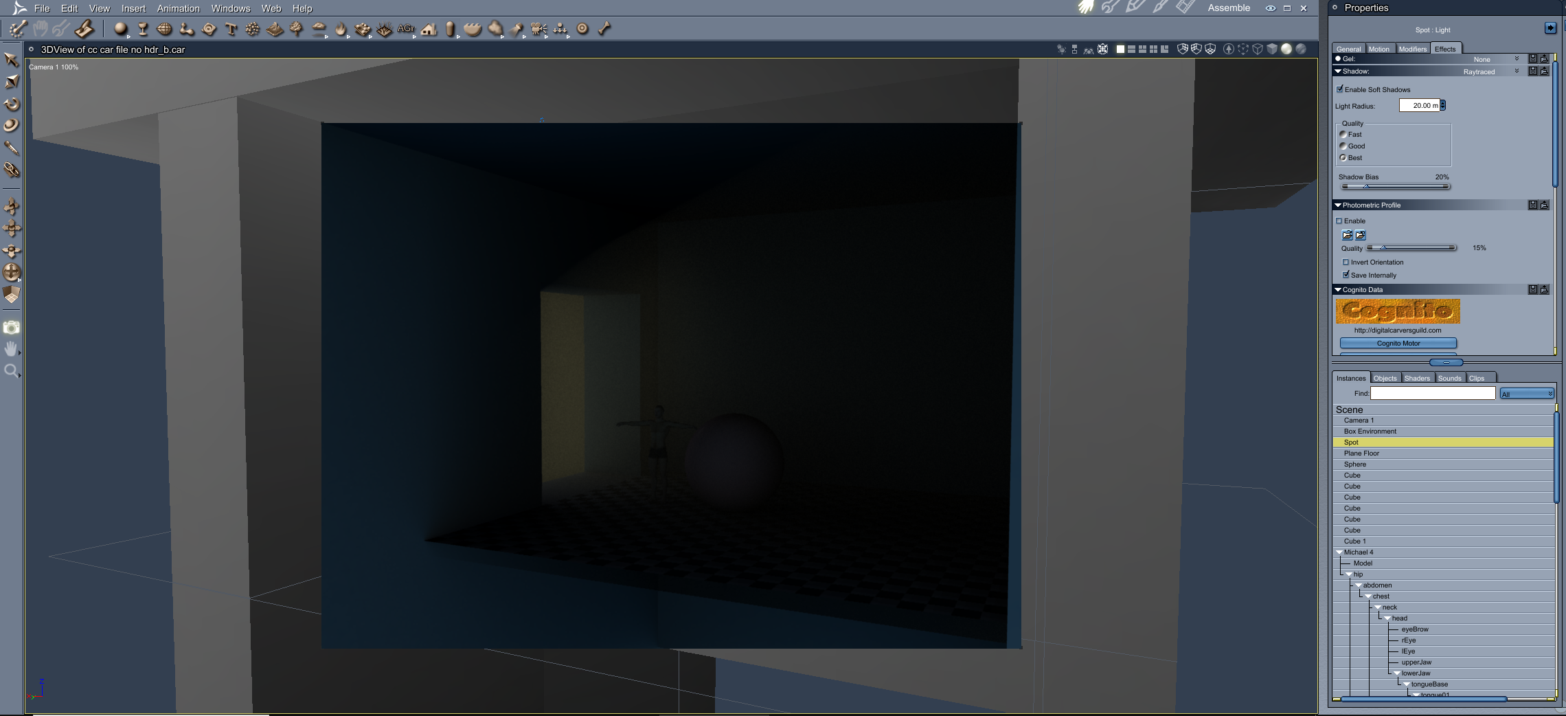

  • Bunyip02Bunyip02 Posts: 9,285
    edited January 2021

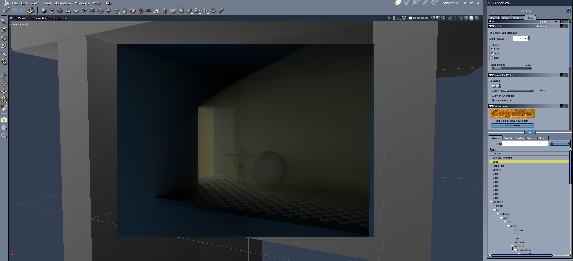

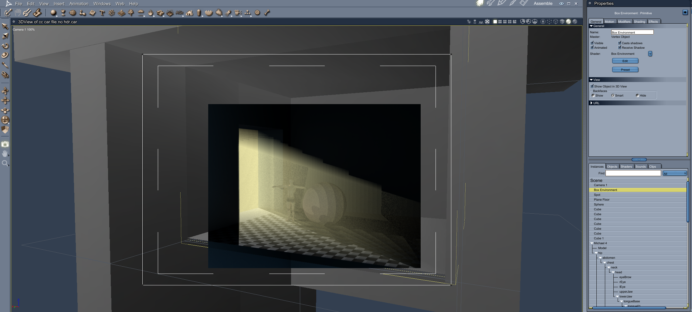

    Diomede, was getting the same results as you with your scene, Vyusur mentioned Soft Shadows in her set up, which I had not explored, when I did I got a nicer result, recommend you try it with your scenes !
    Without soft shadows
    With Soft shadows
    Soft shadows again
    2280 x 1031 - 620K
    2280 x 1042 - 757K
    2274 x 1039 - 837K

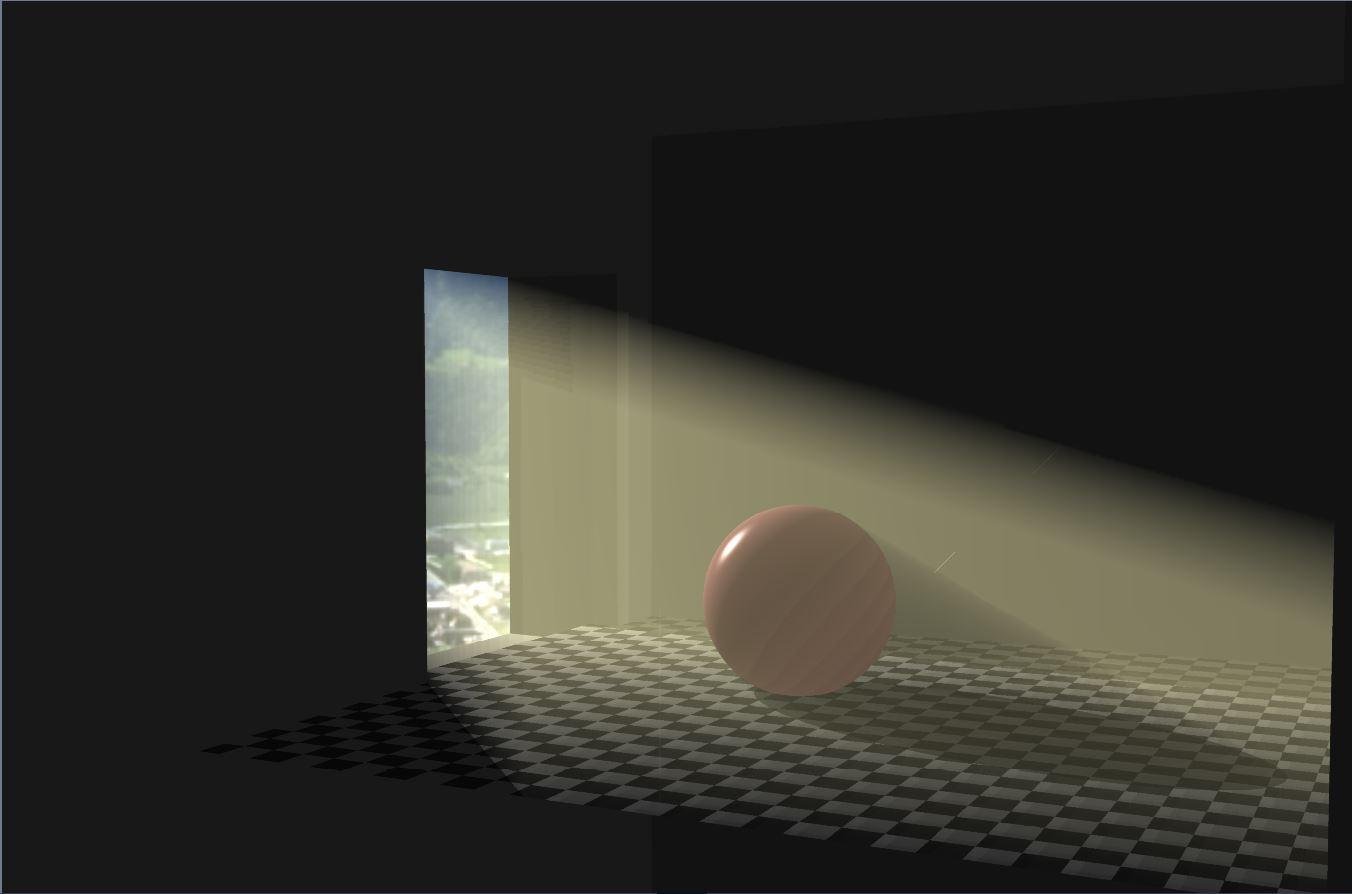

    Diomede, I played with your scene for an hour.  Didn't have any luck getting the HDRI to make a light cone.
    However, the spot light had better results, mostly through a lot of trial and error.
    I changed the light position so that it was more pointing into the window.  In the position it was in, I was surprised that you got any light at all.  Also dropped it to 47%, but this might vary depending on position.
    I changed the window size on the wall to a doorway.
    In the Box Environment, I changed the Absorption color to black.  Now you should be able to see your HDRI.
    Also in the Box Environment, I changed the In-Scattering quality at the bottom to "Good."
    Don't think I did much else.  There is still some banding on the ball, which likely could be fixed with more tweaking.
    For sure, it is a worthwhile technique (using a spotlight) to add to the Carrara toolbox.  Maybe someone else will get the HDRI cone to work.
    Here is the same render as above, using the same spot, but without using the Box Environment.  It really makes a difference.
    1352 x 894 - 65K
    1352 x 898 - 58K
    Post edited by UnifiedBrain on

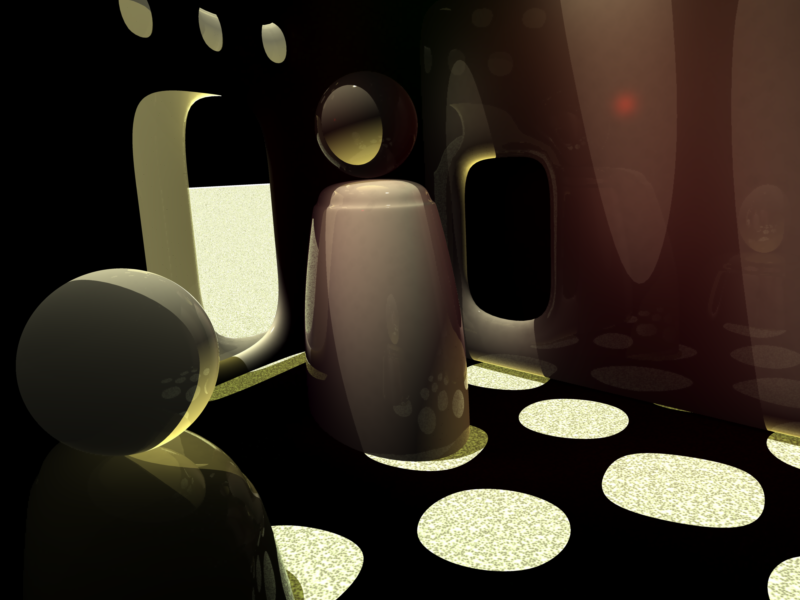

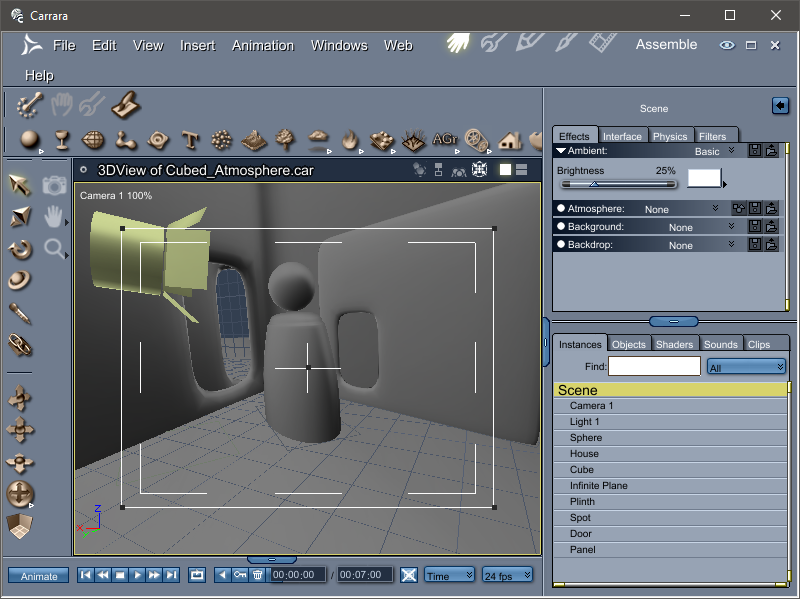

    @Bunyip02 and @UnifiedBrain - thank you for taking the time to investigate my problems and for the reports.  Following your suggestions, I am getting improved results.  Still some artifacts, but much, much improved.

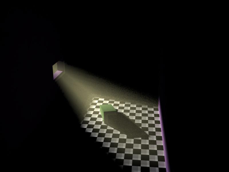

    Here is an example.  Simple scene with transparency box as per Mark Bremmer, a single spotlight with soft shadows, and adjsuted absorption.
    800 x 600 - 20K
    1724 x 934 - 161K
    1439 x 791 - 191K

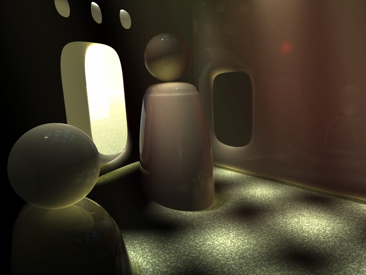

  • This MB box atmosphere seems like fun... [FIRST EXPERIMENT]
    SCENE
    NO BOX
    MB BOX

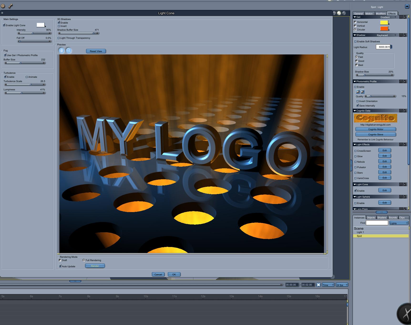

  • DartanbeckDartanbeck Posts: 21,988
    Here's my simple, down and dirty method:
  • MB Box [SECOND EXPERIMENT]
    Changed scene to make it more interesting, perhaps(?)
    Softened the Directional Light shadows
    Added MB Box (click for the bigger picture)

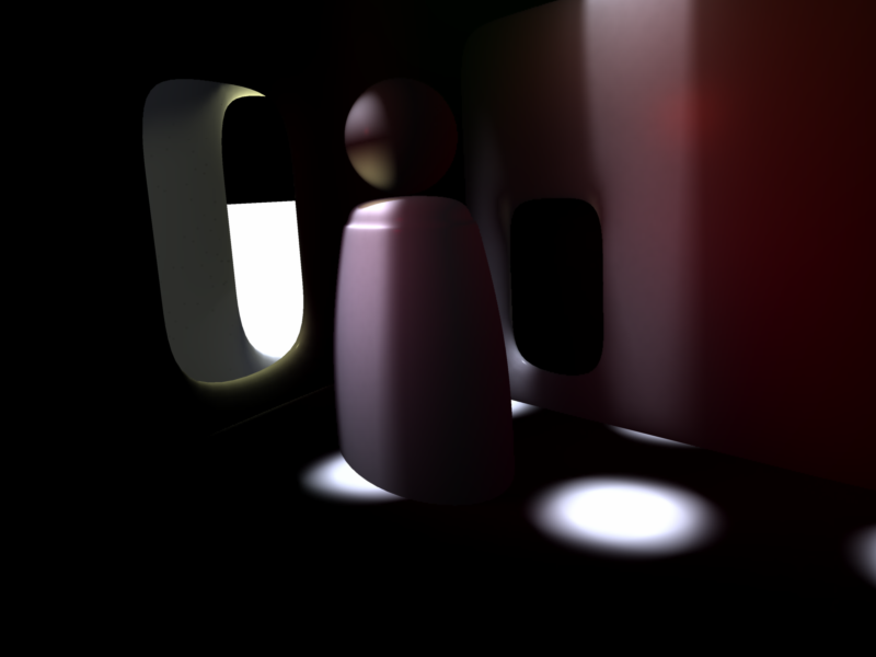

    edited January 2021
    Thank you again, everyone, for tips and demonstrations of the Mark Bremmer box.
    Here is a work in progress for a classic scene.  Spotlight outside window pointing in.  Sphere turned into glowing light (fill light) inside box).  I had tried to put in a rim light and checking the box to limit the light to the figure but it lit up the entire transparency box anyway.  Ended up deleting the rim light.
    Will see if I can do anything useful adjusting the scene, including but not limited to the camera angle, furniture and props, shaders of the wall and floor (maybe a floor rug), expressions, finding a way to enhance the cross, etc.
    800 x 500 - 27K
