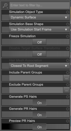

may I have you show us these settings:
Update - texture shaded works properly but the iRay doesn't. I normally use texture shaded (somehow my settings got goobered) so I'm fine, but I don't see it if I switch to the iRay preview mode. I'm not sure if simulated hair normally shows or not in the iRay preview. My hair settings match the ones posted.
And you have the Generate PR hairs on, and the tesselation is greater than 2 for the actual hair?
I am using DS 4.14.0.10. And here are images of my viewport, parameters, and the actual render. The initial values for Viewport Line Tessellation SIdes and Render Line Tessellation SIdes were 0 and 1 repsectively. I raised them to 2 and 3.
The one significant difference I see is that I am lacking the "Hair Mesh Association" parameter altogether.
