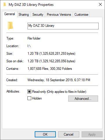

  • WendyLuvsCatzWendyLuvsCatz Posts: 40,586
    edited December 2020
    mmm misread blush1.2TB

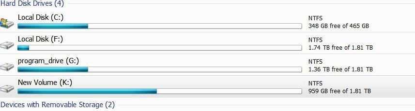

  • IvyIvy Posts: 7,165
    WendyLuvsCatz said:
    I had to move my 120TB off mine cheeky and that's not with the zips
    Yup I had to do the same Wendy I got up to 1.1Tb   , I've been recently breaking that up to 3 other drives getting them more organized
    I am trying to save my main drive C:\ just for software and programs.  I even have moved my PreFetch files and Virtual Memory to drive G:\ to off load some of the burden off the SSD  C:\ drive
     I am sure my content size is mere pittance compare to others here though
