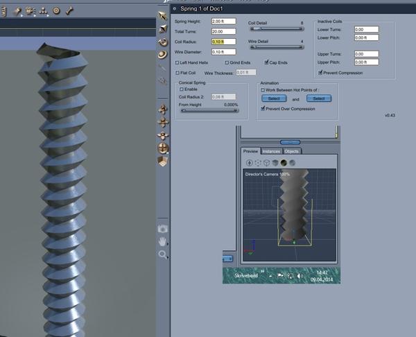

You can use Sparrowhawks spring plugin.
http://www.sparrowhawke3d.com/
I used it for the initial shape.

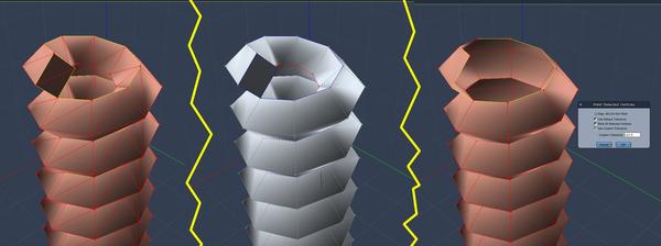

To get a full bolt or screw, some modelling are required.
First create the spring.
Convert to vertex object.
Untriangulate polygons.
Select the inside line, and delete.
Weld the object.
And crease the inner and outer shape of the screw part.
Add smoothing.

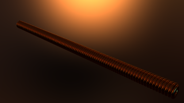

thanks to Andy I got what I was after but other ideas helpful too

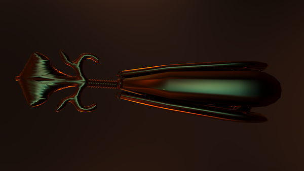

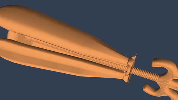

ok finished but not working
running a physics sim the leaves fell off instead of swinging
only made leaves physics motion
as not expecting screw to work in thread though that would be nice

no just Andy's suggestion in spline modeler
took a few tries but got there

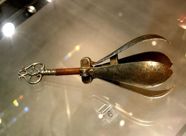

I saw it on the TV program Bones and roughly based mine on this wikipedia image
