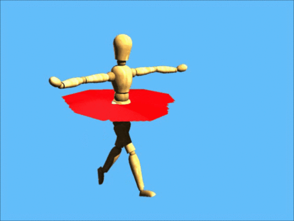

  • Hermit CrabHermit Crab Posts: 876
    Hi, everyone.
    I'm in a complete rush to get out for an appointment but I've taken another shot at animating cloth. I expect failure ultimately but this might be a little step forward.
    The scene is a shambles - the cloth is a shapeless rag, etc.
    But here is a quick result.
    640 x 480 - 4M

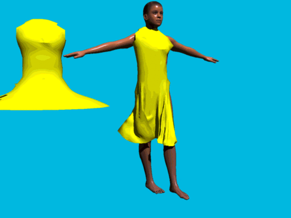

    Hello again everyone.
    Last weekend I got a chance to finish with this.
    The final demonstration of using soft body physics is now on YouTube at this link:
    http://youtu.be/voz7Fke3l24
    It is 15 minutes long and is only about the process of making a draping garment on a figure beginning from scratch. It shows ways to get it wrong also.
    If my previous posts have already shown you all you can take of this, perhaps the brief demonstration of Gravity settings at around 11:40 will add something to what I discussed before and you might want to jump there if only out of curiosity!
    The idea of using simulation results to create morph targets arose and resulted in creating my first ever morph targets. The (imperfect) results follow the part about Gravity.
    Below is a gif showing one of the three morph target results. What looks like poke-through is actually just careless fitting.
    I hope anyone viewing the video will find it interesting - I'll be the first to admit that 15 minutes is a lot to ask!
    I'm more or less finished with soft body and now join the ranks of those awaiting new developments!
    640 x 480 - 571K
