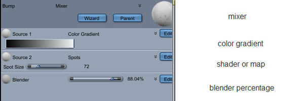

    I generally use a mixer in the shader tree. A combination of color gradient from black to white (with a gray center).
    I use the value (1-100) to set the desired percentage)
    And adjust the amplitude last for minor tweaking.
    The two images show height map changes using "spots" from Carrara. The last image is the settings with the setting showing the inverted (sunken depth) settings (first sphere image shown). (tweak the amplitude for elevation settings i.e. negative amplitude elevates the bump and makes the center more light when using grayscale gradients)
    note: use the blending function in "spots" to get a similar look that I achieved for the shape of the spots and frequency.

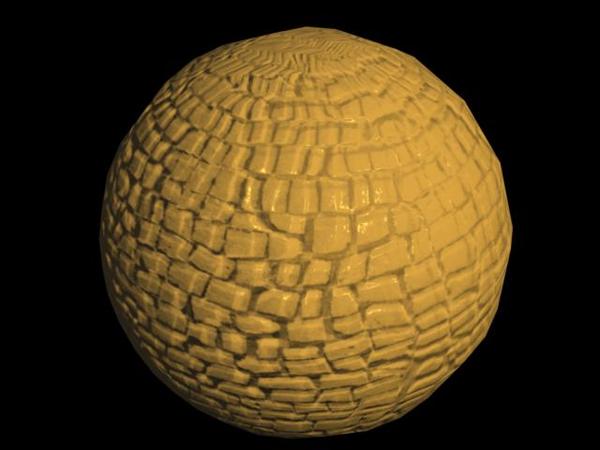

    Same technique as above, but using a texture map where the shader "spots" is.
    In this case I used a Mayang Website map called "mosaic" tiles instead of "spots" and lowered the amplitude to get the effect.
    640 x 480 - 30K

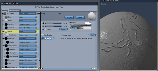

    I crank on the top level slider. Of course, I make a whole bunch of bump maps, sometimes I'll blend two or more together... but not often. I don't really ever lower the brightness of the bump map unless the highs and lows are too drastic at the level of bump I need.
    Terrain shaders have been really fun in this. You can crank the bump up to 250%, but you can enter in values up to 500%. Any higher jumps down to 500%. But with the right bump map, I've been able to make leaves appear as if their laying 'above' the surface, like they do when they're dry. I like using bump.
    I have noticed that we have to be aware of bump levels vs rendering quality. Too low of object/shadow accuracy can make high bump values look fuzzy or worse. Tweak these setting, however, and we can make really great use of bump without the need for displacement, which can take a lot longer in the rendering department.
    I use Veloute Tools Filter (plugin) on image maps. It puts the bump on steroids, and also has controls to crush/stretch the whites and blacks (like a Levels control). I use it most for fixing/limiting specularity maps which can be any random range of greyscale, but in the bump channel it turns maps into super-bumps (not an actual technical term) that extend beyond what usually a B&W image can create in Carrara (not that it's always a good idea because it can stretch way past what looks good into some weird and ugly territory).... It also works to stretch/limit Carrara's procedural shaders.
    Just checked Inagoni's website. He calls it "rich bumping"...
