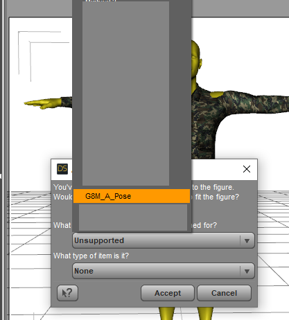

    The data folder is merged somehow with the existing data folder. [if on Mac, think you have to copy/paste] Concept is that there is only ONE data folder under My Library.
    Then with G3M in the scene, in loading any G8M clothing [esp. with long sleeves or pant legs], select the G8M_A_Pose from the auto-fit dialog.
    Depending upon which figure and clothing is being used, my autofit clones have references to either a T pose or the A pose.
