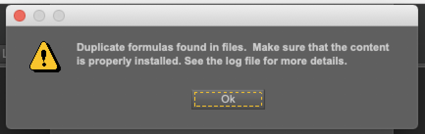

  • mavantemavante Posts: 734
    Sigurd said:
    I just bought a couple of days ago and used it for the first time this morning. Now everytime I load a G8M I get duplicate file message.
    Anyway to undo this?
    Thank you.
    I am getting the same thing every time I load ANY character now, including G3 females. I'm on DS 4.12 on Cataalina. See attached.
    The so-called "log" file under Help has been no help at all. The only thing it says is something about "sdksource/cloud" and then a string of gobbledegook that I have no idea what it means and don't want to know. I have ZERO "cloud" files anywhere.
    I don't know what has started causing it. It just started out of the blue. It's an annoying bug.
