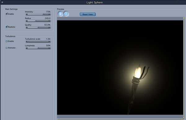

I've been asked to post the settings for this video. This actually uses three elements. The fire primitive, a light bulb with some effects, and a particle emitter.
There are some caveats to using the fire. It does not react to scene forces and it has no controls to simulate forces such as wind, wind direction, or wind speed. These would be welcome improvements in future updates. It can also cast shadows, they are not opaque, but it can cause some weird artifacts, so if you don't want them, I would turn off the cast shadows option. The fire primitive can also provide illumination provided you use Indirect Lighting in your render.
I couldn't find the original scene file, but I did save the torch to my Objects browser and that includes everything except the particle emitter which I'm trying to recreate
I've found that the default colors are too cartoony. I find I can get a more accurate look if I adjust the colors much brighter. Yellow in the base color and I usually brighten that to a very light yellow. Of course, there are times when you'll want a more fantastic color such as for a magical or sci-fi effect, in which case, whatever color you choose, I would go for a bright version of it.
I also like a high detail, and high edge falloff. I usually don't increase the pointiness from its default and many times I will reduce it somewhat. I've found an upward speed of 8 or 9 works best for me. Your mileage may vary.
The fire itself doesn't cast a light unless you use Indirect Lighting in your render, so what I do is stick a bulb light into the fire. I leave it pretty bright and set the color to approximate the fire's color. I also add a 3D Light Sphere in the bulb's effects tab. This helps sell the brightness or heat of the fire.
If you are animating the fire, the fire should be set to 0% at the start of the animation. Scrub to the end of the timeline and adjust the fire's completion to 100%. To get a flickering firelight, you can set the bulb's brightness to 100% at the beginning of the animation and 50% at the end. Change the tweener type to noise and choose Cubic. The T-scale is the time scale. Fire flickers rapidly, so you'll want to to adjust the slider so that you get a lot peaks and valleys. You can also clamp the peaks and valleys if you feel the valleys or peaks have too much variance.

    Here's the setting for the light sphere:
    988 x 639 - 121K
    I should add that depending on your needs, you can change the container type for the fire. I used a cylinder for the torch, but a box works can work well for a campfire, a sphere is great for your spell casting mage, or a Sci-Fi energy weapon, etc.

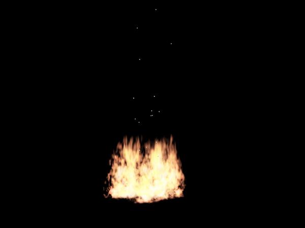

    I'm working on recreating the particle emitter. I can post a link to a scene file when I get it done. I'm almost there. The particle velocity is what's causing my greatest problem.
    Here's a scene with a fire and particle emitter I put together this morning. It is an animated scene set at 4 seconds. I didn't add a light to the fire. Feel free to use what you want from it, in any manner you wish.
    https://dl.dropboxusercontent.com/u/7370483/Fire_and_emitter.car.zip
    1200 x 900 - 66K
