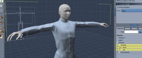

  • DiomedeDiomede Posts: 15,393
    For Genesis figures, you should have choices for the add on packs that you have acquired. For example, to get clothes designed for M3 or V3 to auto fit to Genesis in Carrara, you would have to have and install the Gen3 shape pack.
    Here is the one for M4 and V4.
    http://www.daz3d.com/v4-and-m4-shapes-for-genesis
    If you have acquired the one for M4 and V4, then check to make sure that it is installed correctly.
    For Genesis 2 figures, there are some known bugs for autofit.
    I am attaching a screenshot of a jacket made for M4 that has been autofit to Genesis in Carrara.
    945 x 386 - 60K
