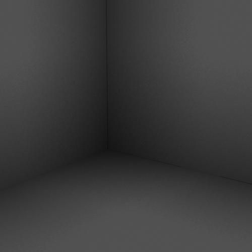

    Ok, I'm seeing another similar weird lighting thing going on. I'm not sure if it's related or a completely different issue. I'm also not sure if it's a problem or just something I'm doing wrong.
    This time, there appears to be bright light in just the inside corners of this room cube.
    Oddly, zooming in doesn't make it larger; it seems to remain a small line of about the same scale regardless of whether I view it from afar or zoom in close. I've deleted everything else from the scene except for a small cube for scale, and have done two spot renders in two different camera views so you can compare. I didn't see the problem with any other objects in the scene, however perhaps the colors and lighting were such that it just wasn't obvious except for here.

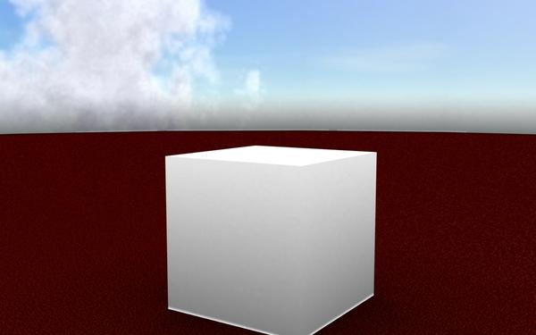

  • srieschsriesch Posts: 4,243
    I'm seeing something similar in a different scene. Scene has nothing but a sphere for a skydome, a plane for a floor, and a cube. The bottom of the cube has a bright line around it where it meets the floor. Possibly the issue exists in places where the floor hits the skydome but only in places, but it's kind of hard to tell there as it is less obvious.

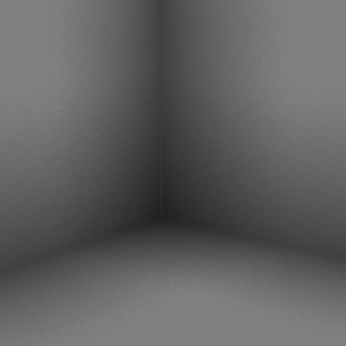

    The corner/edge lighting is a actually a geometry problem...more properly a lack of geometry.
    Walls made up of 'single thickness' planes will exhibit that 'property' under many lighting situations.
    The first image is walls made of planes. UE2, occlusion, soft shadows, 64 samples.
    The second is a corner constructed out of walls with 'thickness'. Same lighting. Notice the 'dark' line...it is getting occlusion and heavily self-shadowed. This can be corrected by adjusting the shadow bias.
    The same thing can happen when a 'single' thickness plane intersects something with some thickness.
    Also, the number of faces involved has an effect on it...more faces, less likely to happen. So a couple of large, single face planes will be very likely to do that.
    As to the 'doesn't work'...it's a 'feature, not a bug'...it's something like the deep shadowmap problem that goes waaaaaaaaaaaay back into basic render code and has been around for ages. 'Watertight'/closed geometry without any intersections goes a long way to subdue it...but...

    Interesting. Ok, so what is an "appropriate" UberEnvironment shadow bias to use for most scenes, if there is such a thing? I see I had just turned it up from it's default of 0.1 to 1 to eliminate a gridwork of lines on the skydome, now I sort of think I understand why that was happening.
    For this reason, does it make sense to always create primitives that have lots of extra polygons, even though that sounds like something one would normally want to avoid, and to always use a squashed cube in place of a plane?
    It depends...it doesn't always happen with all lights...but with 'environment' lighting it is common. Also, if you can get a primitive to touch, but not intersect a single thickness item, then it goes away (a very tiny offset...like a y value of 0.0001 works too).
    Shadow bias is one of the least used but most often needed settings in DS. And there isn't a 'one size' solution...

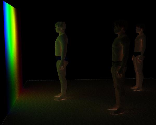

  • AndySAndyS Posts: 1,449
    Hi,
    what do you mean, talking about "thickness"?
    The problem of glowing edges isn't only for the corners of plans. I noticed it really strong for skin surfaces, too.
    As soon as I use UE2, especially as IDL, I get that glowing.
    In the picture you see it really strong where the skin of my characters is near to a differen surface (different objects / planes or other skin areas - as between the fingers).
    So what in detail (for newbies) is the solution to cover it?
