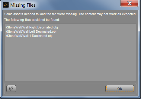

    I have a new problem after transferring my scenes. When loading one of my scenes, it couldn't find my obj files. Thankfully I have the .objs backed up, but the error message doesn't give me a complete path. Just this much. /StoneWall/Wall Right Decimated.obj . This does appear to be the old path before I wiped Daz off my computer and installed the latest. How can i get the scene to load the .objs now that the old path does not exist?

    What is the EXACT error message when it can't find the geometry for the wall?
    Screenshot of the error box should be enough...
    Also, what format are the scene files in?
    Post edited by mjc1016 on
  • edited December 1969
    Here's a pic of the message i get below. I "think" i can locate the .dsf files that are in the geometry folder of the backed up daz directory on my passport drive. For instance right here, F:\_Genie Timeline\0\C\Users\My name\Documents\DAZ 3D\Studio\My Library\data\auto_adapted\Wall Left Decimated_208913\geometry_ba04eae1_5862_ec59_6175_387eaa6e8afe. The file in that folder is "Wall Left Decimated.dsf." However, the error message is looking for the obj.s. Is it possible to gather the right files off my passport backup and get them into the right place in my new 4.6 install? I backed up my last daz installation to my passport and then wipe every vestige of Daz off my computer and reinstalled 4.6.
    467 x 327 - 26K

    It may be that it's asking for the .obj's because it can't find the .dsf's and is trying to rebuild them, in which case putting the .dsf's in their previous (relative) location should fix it.
  • edited March 2014
    Problem is i don't know where the correct relative location is. That's the frustrating part. I wish that it would offer another dialog box that would allow you to direct it to the objs to get them.
    Update: I fixed one of the scenes that use the objs and now they are available to all my scenes. I was hoping it would do this. Yahooooooo! lol. One happy camper!
