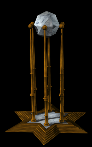

Hello!
Back to my model project... And I decided to make a WIP thread since it's not working so well now.
I have two pictures. One is just the geometry with no textures so you can see the project.
Now, regarding the other one. As some of you already know, I'm quite new at 3d and just have Carrara for some weeks. So when it came to texturing I wanted to do it for now in Daz Studio to see how uv mapping is working since I am more familiar with the software. I will soon know how to do it in Carrara to, but one step at a time and is more quick if I try to see how things are working. I know this is a carrara forum, but I think that this problem as more to do with something in uv mapping than with daz studio, since I'm using the same technic I use to retexture objects in daz and this never happened.
As you can see, there's this part of the pilar where the texture is stretched. I believe it as something to do with the edges of the shape in uv map. It happens with every type of uv map I do. In this case is a cylindrical uv, but I've already tried planar, box... and it always give this kind of stretch.
Does anyone have an idea of why is this happening and how can I correct it?

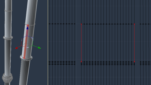

    So, in Carrara now :)
    I guess this is the problem for what you explained. This particular polygon appears like 2 lines in the uv map.
    It seems that is keeping this polygons out and just using the edges to finish the map. Those 2 edges that appear in red on the uv map (one from each side of the polygon) should be the projection of just 1 edge, but for some reason carrara is doing it like this.
    This is a cylindrical projection.
    Have no clue what to do... :P

  • DartanbeckDartanbeck Posts: 22,150
    There are ways that we can get automated UV Mapping. One is like we've just done, 'projection'. Another way is to unwrap, where you actually assign seems and pinned areas to have the software unwrap the model into a flat plane - and that is incredibly awkward for me to try and explain. When you get to Phil's Advanced Training, he shows in ggod detail how it's done, but even learning that - unwrapping is not always an easy task.
    The quickest method that I can describe here, let's use your above image as an example.
    You can see how when the one polygon is selected it makes a line, right?
    What needs to happen is to take one of those edges and slide it over in the Map window.
    Here's what you really need to watch out for - if you select and drag the wrong (of the two) edge, the texture will suddenly invert on that polygon, making the result that you have now, but worse.
    So after making the change with one, do a test render to see what happens. Pay attention to which one needs to be moved to get the proper result. You can see which is actually selected by looking at the selection on the model in the left window.
    Just remember that all of the polygons along that row, up and down, have the same problem - so you'll have to fix one edge for each all the way up.
    The hardest part will be moving one without grabbing the other in the process.

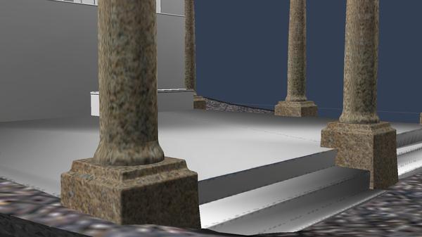

    Thanks for bringing this up, Tania - I've just spotted I have the same problem myself!
    1726 x 968 - 247K

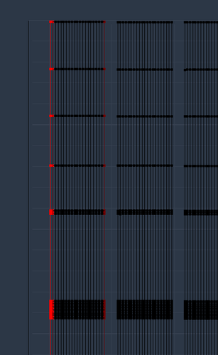

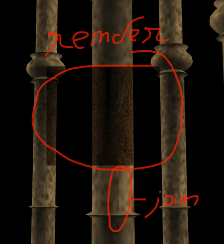

    Tim A - If you are still having this problem, just to say that after all I had to do one more thing. It was working very well, but then I had to resize the map to have a proportion more close to the one of the columns or the texture would be very strange. When I did that, that squeeze part appeared again. So what I did was:
    1 - selected all the polygons on that row
    2 - in "operations" did a projection of that polygon (only that polygons, not the entire column)
    3 - align the points of that projection manually so that they would stay in the part they were should be
    As you can see in the first image, that red lines are a separated part from the rest. That's the line of polygons I projected separately. It was with a really strange shape when I projected, but after a little work it's perfect. Just take attention to the edges - you must chose a side to join them and you must join the lines that correspond to the same edge.
    In the second image you can see how it works in daz. You now see the join of the two sides of the projection. But it almost doesn't appear in the render. You can make the join perfect working on the texture so that the 2 ends fit nicely.
    703 x 768 - 314K
    465 x 758 - 14K

    Almost, it seems, but not quite. What seems to happen is that 19 of a 20-side cylinder are laid out exactly as you describe. But the last one, No 20, wraps back from the right side to the left. Maybe this is a bug, because it seems to me that it shouldn't do that. Or perhaps you have to specify a seam, like when you do unwrapping? I haven't tried that.
    What I did on mine was detach the "back" poly (actually, a row of polys) and then move it into position next to the others, and resize. May not be the best way, but it does seem to work. :-)

    So, my Wacom arrived yesterday and I've spent a good amount of time around my new toy... :)
    But I got back to my model before I got lost in digital painting.
    For now, I just have the textures in the diffuse channel... I really worked out so that the joining parts would be clean and it really took me hours on photoshop make them join perfectly in the columns and spheres. Thankfully, in the top crystal I figure it out at first try! :)
    Now, let's go work this surfaces so that they look really nice!! There's still lot of texture work in front of me!! :)
    555 x 889 - 219K
