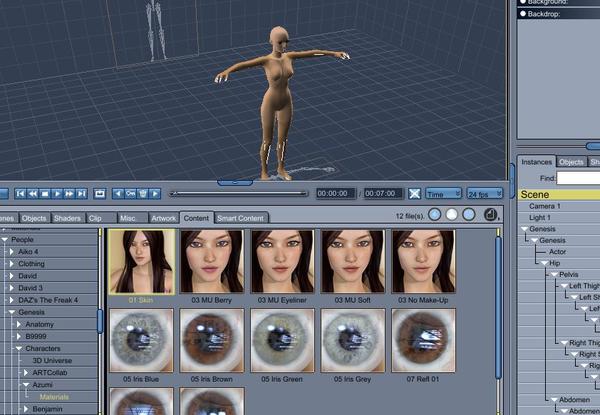

I have not been able to figure out how to get the Materials for Bot Genesis to work with Carrara. Attached is the difference between Daz Studio and Carrara. Is there a way to get Bot Genesis to work in Carrara?
  • DiomedeDiomede Posts: 15,468
    edited March 2014
    I don't have the product so this is just a guess. Until someone who has BotGenesis comes along, I have a few suggestions.
    1) Daz has been setting the default placement of some Genesis-related materials as a subfolder for the character. For example, in the attached pic, the materials for the Azumi character for Aiko 5 of Genesis is in a subfolder of the Azumi folder under Genesis under People in the "My Daz3d Library" folder. That is using default install, so if you do custom installation it would not apply. However, the materials will be wherever the creator put them, so they could be in a materials subfolder. In any case, explore your My Daz3D Library content folder.
    2) Use Daz Studio as a plugin. Load the BotGenesis in Studio with the materials that you want, then in Daz Studio choose File / Save As then choose a character preset. You should have a "My Library" folder in your Carrara content browser with a subfolder called presets and a further subfolder for characters. try loading from there.
    3) Dare you try the Smart Content tab? I never do, so that is just exploratory.
    842 x 583 - 101K
    Post edited by Diomede on
    The other possibility is that the textures are not image map based for once, which would be weird for a DAZ Studio product. ;-)

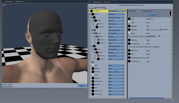

    I have seen this happen on a few items in Carrara. For me, it was the shader setting.
    See the screen capture. This is a Michael 5 character loaded into an empty scene. There are several "phillip" textures. The ones with facial hair all make the entire face black.
    I can correct the issue by changing the shader, but I lose the hair (apparently the hair is created by some shader magic and not part of the actual texture map).
    Take a look at the shader tree and see if it has extra "black" elements like the one shown here.
    On the plus side, Carrara has some good metallic shaders and they are easy to adjust to get the effect you want.
    1341 x 773 - 209K
    I think I can explain some of what is going on...
    The second element, in that shader looks to be either the displacement or specular map, when used in Studio. Both are greyscale maps, so it's hard to say without actually seeing it (but spec maps usually are much darker). And doing any sort of blending with one of those as a texture will definitely make grey...or black.
    For the Phillip facial hair, it looks like they are alpha mapped png files to use in Studio's Layered Image Editor...so the Studio preset will load them to the LIE...

    Finally got a chance to try your suggestion. Either I misunderstand, or it doesn't work.
    The face texture map covers the entire face (black area in my previous post).
    The "hair" overlay only covers the area where hair is supposed to appear.
    Putting the hair in a second color channel (whether overlay or another method) yields some interesting results. The closest I came to something that works put hair across the entire face. Kind of like a wolf man thing.
    As far as I can tell, there is no way to limit the area where the facial hair texture map is applied.
    Frankly, the easier solution is to load both maps into photoshop, overlay them there, then bring back to Carrara as one face map without all the overlay jazz. Trying to shoehorn in this odd type of texture map into Carrara's shader system seems like a lot of extra work for minimal gain. Unless I am completely missing something. (Which would be fine - I am happy to learn something new).
