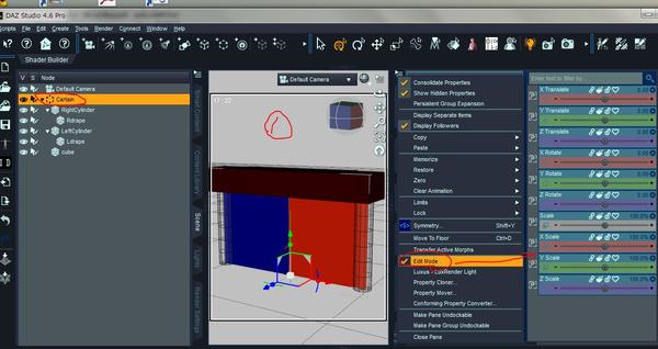

1. Create new group then set all objs as child of the group , to make one hieralchies.
it is important to save objs with ERC controller as scene subset. or you lost all ERC. pic1

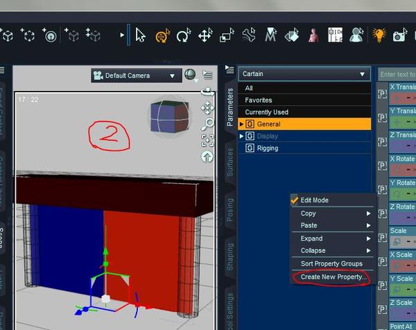

2 make new property = controller for Root node Group.
select Group node , then go to parameter tab, r-click tab, check on edit mode.
then, r-click any place in parameter tab, then select ,Create new property. pic2

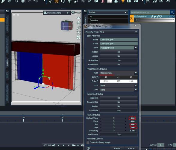

3 I set name as CtrlDrapeOpen, it is controller so that I set type modifier poze,
then I set limits 0 to 1.00 . I plan , when the value = 0 default, two planes are closed ,
the value = 1.00, drapes are full open. (change x scale about 5 % )

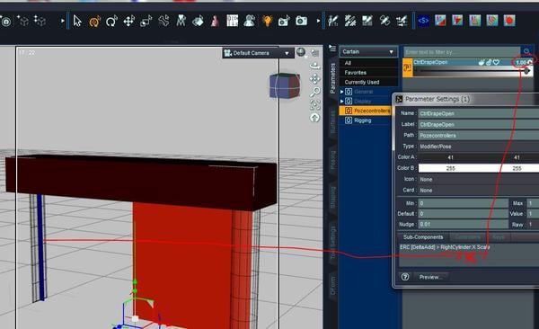

4 now you have new controller for Root group node. like my pic.
5 next, r-click on the new controller, then "show in property hieralchy" pic4
It may auto open "property hieralchy pane" like my pic.

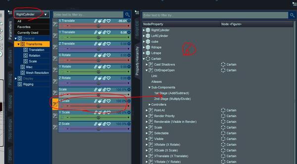

Then,., set ERC in property hieralchy pane, by drug and drop each X xcale, then set attribute.
I continue ,,
at first, just set one ERC for Cylinder R X sclale.
I need to set "cylinder R x scale" as sub componet of the CtrlDrapeOpen.
then it should change from 100 to 5% = 1.00 to 0.05.
the controller min 0 to max 1 ,
,, use type delta add, then "step value (scalar)" should be 0.05 - 1.00 = - 0.95.
this is my planning befor set ERC.
lets set ERC,,
select R-cylinder, then Select X scale property , in parameter tab.
you can drug it ( click on the "p" left side yellow mark) to under the CtrlDrapeOpen > sub component> 1st Stage >
in Heralchy pane.
then you can extract, left triangle and change each value, by clicking.
set each value correctly, like my pic. ( you can use other type too,, but now simply use delta-add ^^;)

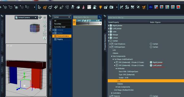

it is all.. lets check controller how work.
select Root gorup, then tweak your controller, it should be change Cylinder R X scalie from 1 to 0.05,
(I set min max limits for Controller, so that cylinder X scale, not change scale under 5%, by Controller.
and you can see parameter setting too.
now I believe you can add one more ERC for left cylinder x scale, as same way.
as sub componet of the CtrlDrapeOpen. it should be like my pic,
after that you can save this group as scene subset with new controller.(keep ERC too ^^b)
