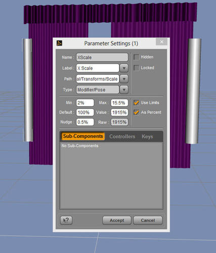

I've created a set of drapes for my living room scene and they can be opened and closed. That part was simple. Each drape is attached to an invisible cylinder. By expanding or contracting the X scale of the cylinders the drapes appear to open or close.
My question is, is there a way to make both cylinders expand or contract using only a single controller? I notice that in the Parameter Settings there are Sub Components and Controllers which might do the job but I can't even open them up to find out.
Can someone direct me to the easiest method to gain what I desire?

    I was right about the Sub Components and Controllers. I just recently bought a tractor from Daz and noted the steering controls both front wheels. I looked at the parameters and sure enough there it was.
    So, I tried to duplicate the wording in my drapes and while I can type in I can't get the system to accept it. What's the trick, or is that a trade secret?

    It's not a trade secret. What you're looking for is called ERC - Enhanced Remote Control - and its a way of linking 2 or more parameter channels in a figure so they're controlled by a single channel (slider). However, it can only be used with figures and you appear to have props. Secondly, its a fairly complex procedure, although there may be an easy way to do it within DS. That I don't know, since I do it by editing the .cr2 so that it also works in Poser.
