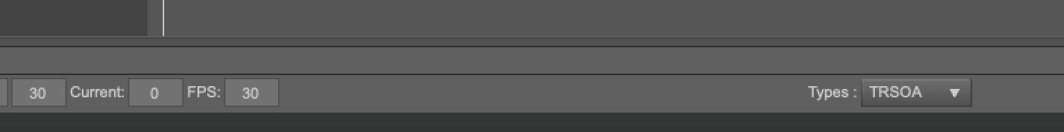

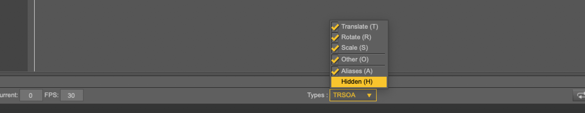

    Hey! Okay, so I took some pictures for you to help guide you! The first two pictures show where the hidden thing is on the timeline. Then just go to the character and open up the properties tree. Then it's General, and then it should be under Pose Controls.

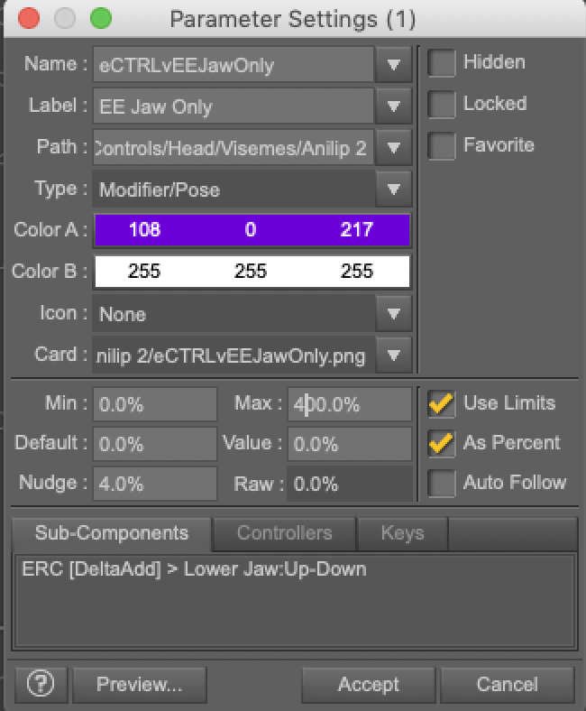

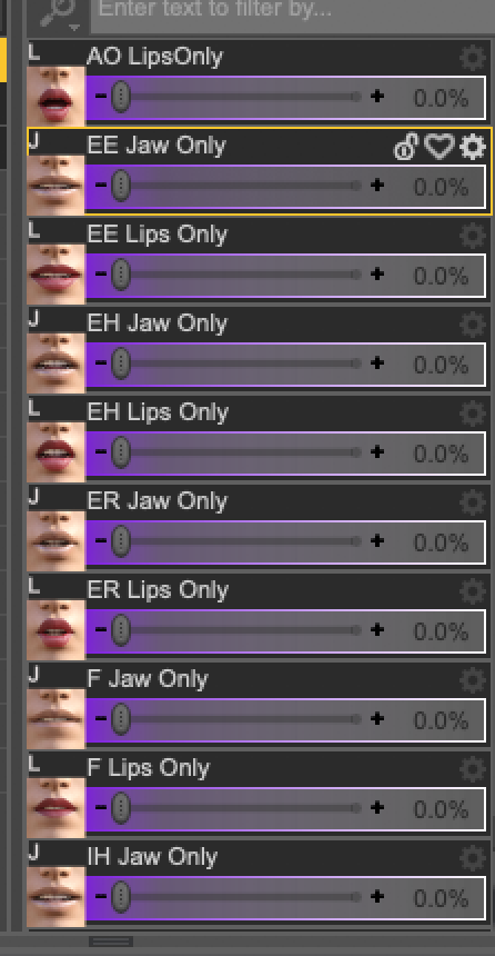

    I also took some pictures to show what I was talking about with the 400% thing after you move the keyframes. I'm taking these with my iMac, so I can't use Anilip 2 to show you (my PC is baking something for Blender right now), these might be the right visimes or they might not, but you'll know what the right ones are once you have stuff on your timeline. Then when you go in the gear shift option thing, you'll see that the max will be set at 400%, bring that down to 100, or like I said, I bring it down to 60% and then nothing will go above that threshold.
    Hope this helps!
