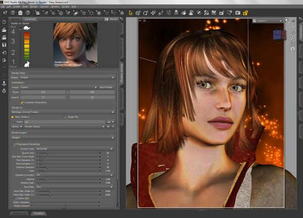

    I just loaded up the Ready to render Fiery Genesis scene in DAZ Studio Formats -> My DAZ 3D Library -> DAZ Studio Tutorias and rendered it. I've attached the render and render settings I used.
    It looks like the lights are too intense in your scene. Can you try rendering the pre-made scene?

    3Delight IS the included renderer on Studio. That thread you linked to discusses using the stand alone 3Delight as a supplement to DS...primarily to free up DS so you can do other things, while rendering.
    But in order to use 3Delight, you need to have your render settings properly set...which means Level 4/Best. All the others are settings for using the OpenGL renderer. All the shaders and materials in Studio are geared towards being used by 3Delight, not OpenGL.

    So by using "Level 4 Best" you're using 3Delight? That's all? That seems to address alot of problems. =]
    gnaws said:
    mjc1016 said:
    3Delight IS the included renderer on Studio. ......you need to have your render settings properly set...which means Level 4/Best.
    Yep...that's 3Delight.

    About exactly what I said, don't use OpenGL renders (which are anything below 4)
