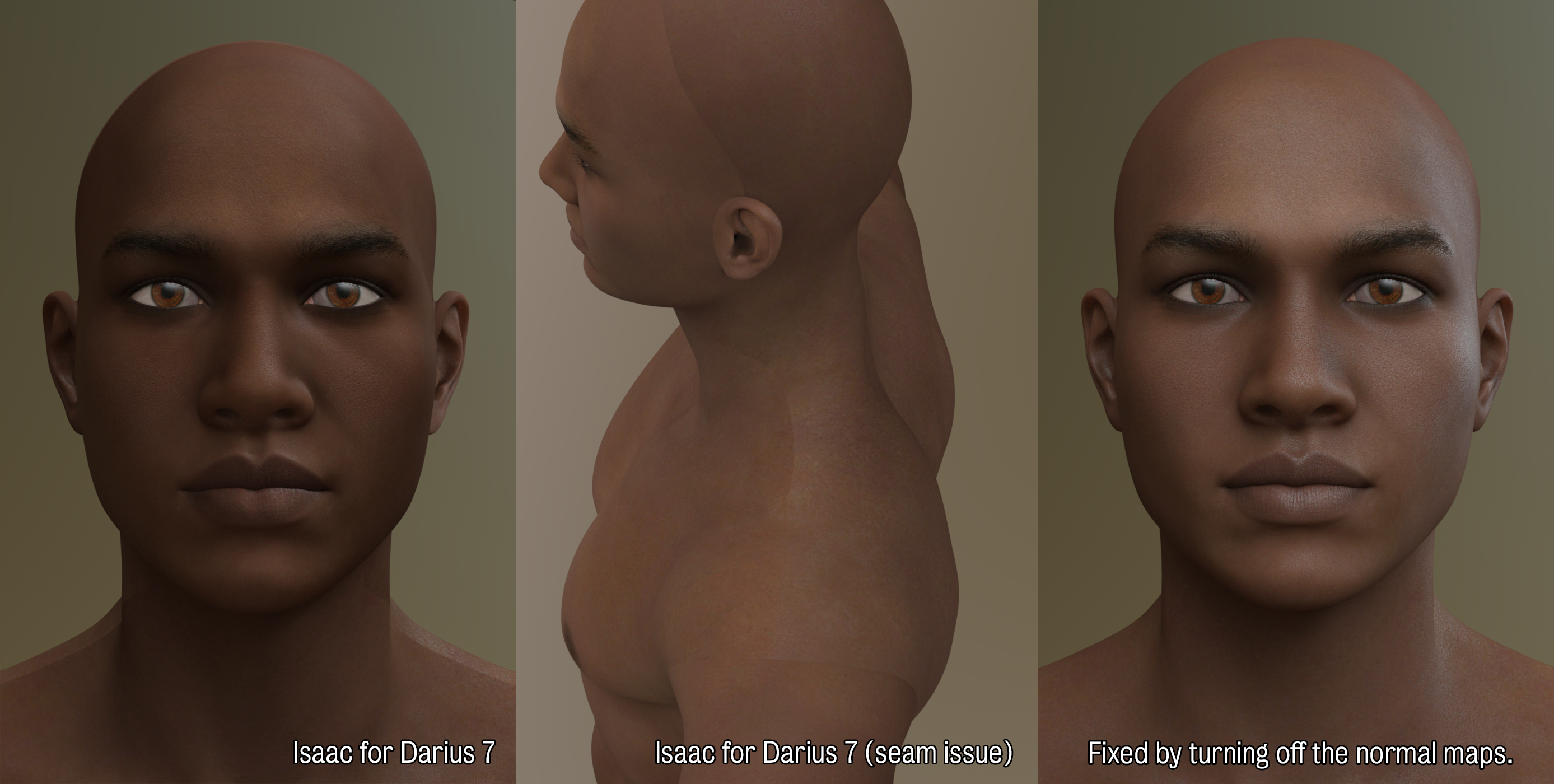

    Isaac for Darius 7
    • Isaac for Darius 7 has the problem which has popped up recently of characters showing seams when their normal maps are on. Luckily, the character comes with a preset to turn off the normals. Of course, that also means you lose details the map applied. Not sure when the fix for that will happen, but I couldn't fix the issue with this one any other way :/.
    • Interestingly enough, turning off the normals made the skin look better.
    2622 x 2626 - 8M
    2775 x 1400 - 4M

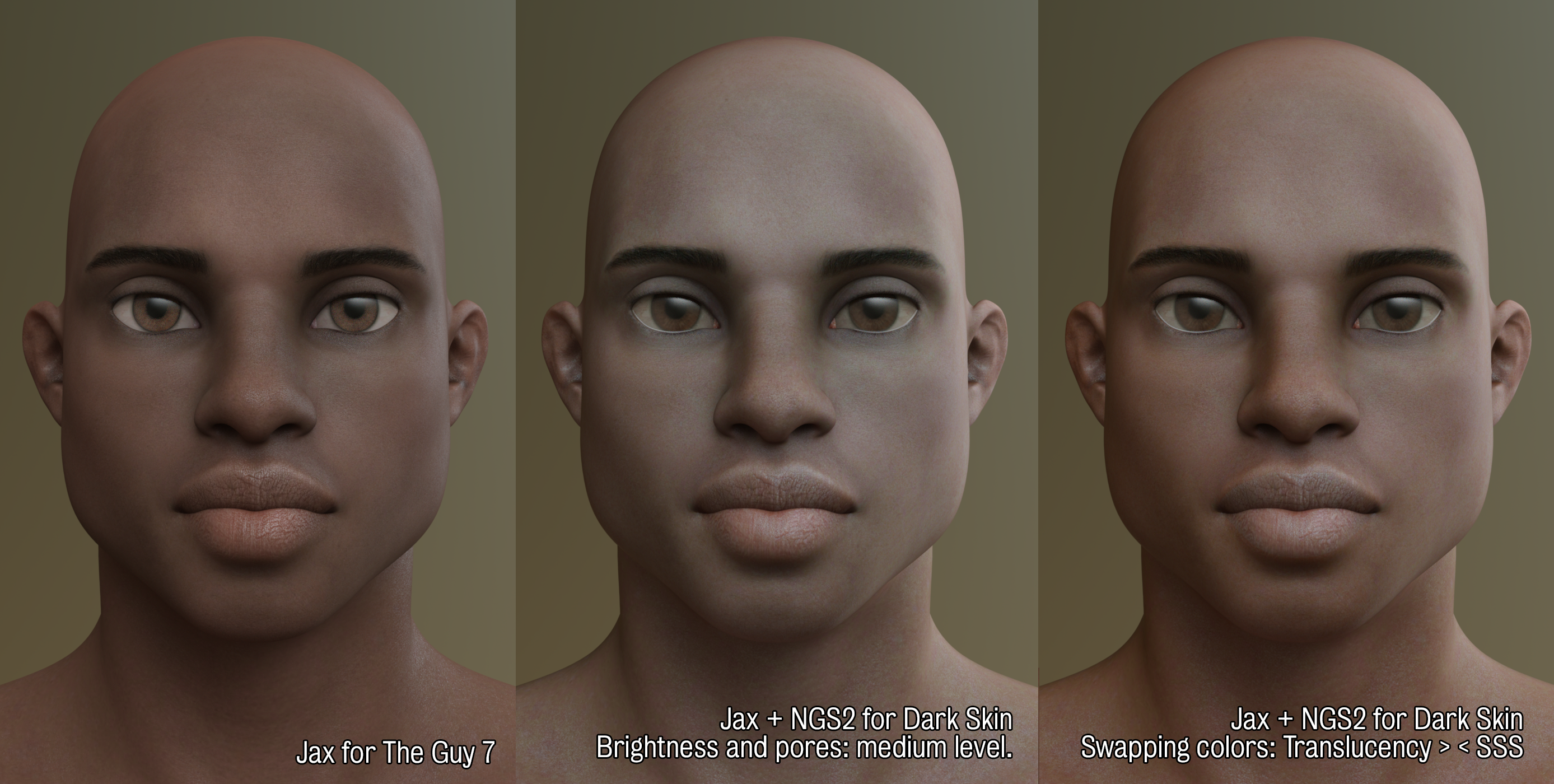

    Jax for The Guy 7
    As expected, NGS really improved the skin by making it react to light better. Applying the tweak (swapping the translucency channel with the SSS channel colors) help restore the original tone of the skin. I remember NGS was updated at some point to introduce additional presets to deal with dark skins. So I've applied the preset called: "Anagenessis 2 Dark Skin Genesis 3" for this test.
    2775 x 1400 - 4M

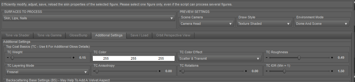

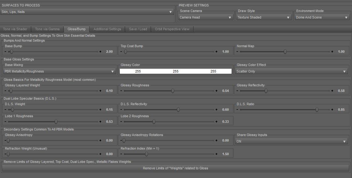

  • evilded777evilded777 Posts: 2,483
    edited February 2020
    Here's the Iray Skin Settings thread. As noted, its a little dusty... there hasn't been a lot of action in there in a while and there is a lot to take in.  At some point, I'll go in there and distill the relevant posts and make links.
    There's geat stuff in there for Specular, Nails, Eyes...
    I'm going to toss out my specular settings, because I think they work nicely and are getting more near real.
    Your going to use ALL the Specular options. Oh, and I should have stated I am using Metallic Roughness for all this,
    Set the Glossy Layered Weight to .1 and the Glossy Color Effect to Scatter Only. Glossy Color should be pure White.
    Glossy Roughness is .54, Glossy Reflectivity is .58
    Set Dual Lobe Specular Weight to .15, DLS Refl to .60, DLS Ratio to .85
    Lobe 1 Roughness should be .53, Lobe 2 Roughness should be .33
    Feel free to tweak the Rougness values and the overall Weights to get the effect you want.
    Now, set the Top Coat Weight to .15, set the TC Color to pure white.  TC COlor Effect should be Scatter and Transmit and the Layering Mode should be Fresnel.
    Set the TC Roughness to .49 and the TC IOR should be 1.5
    You can plug the bump or normal map into the TC Bump channel, or if you have a noise maps you like for this, plug those in here.
    1140 x 577 - 39K
    1159 x 268 - 24K
    Post edited by evilded777 on

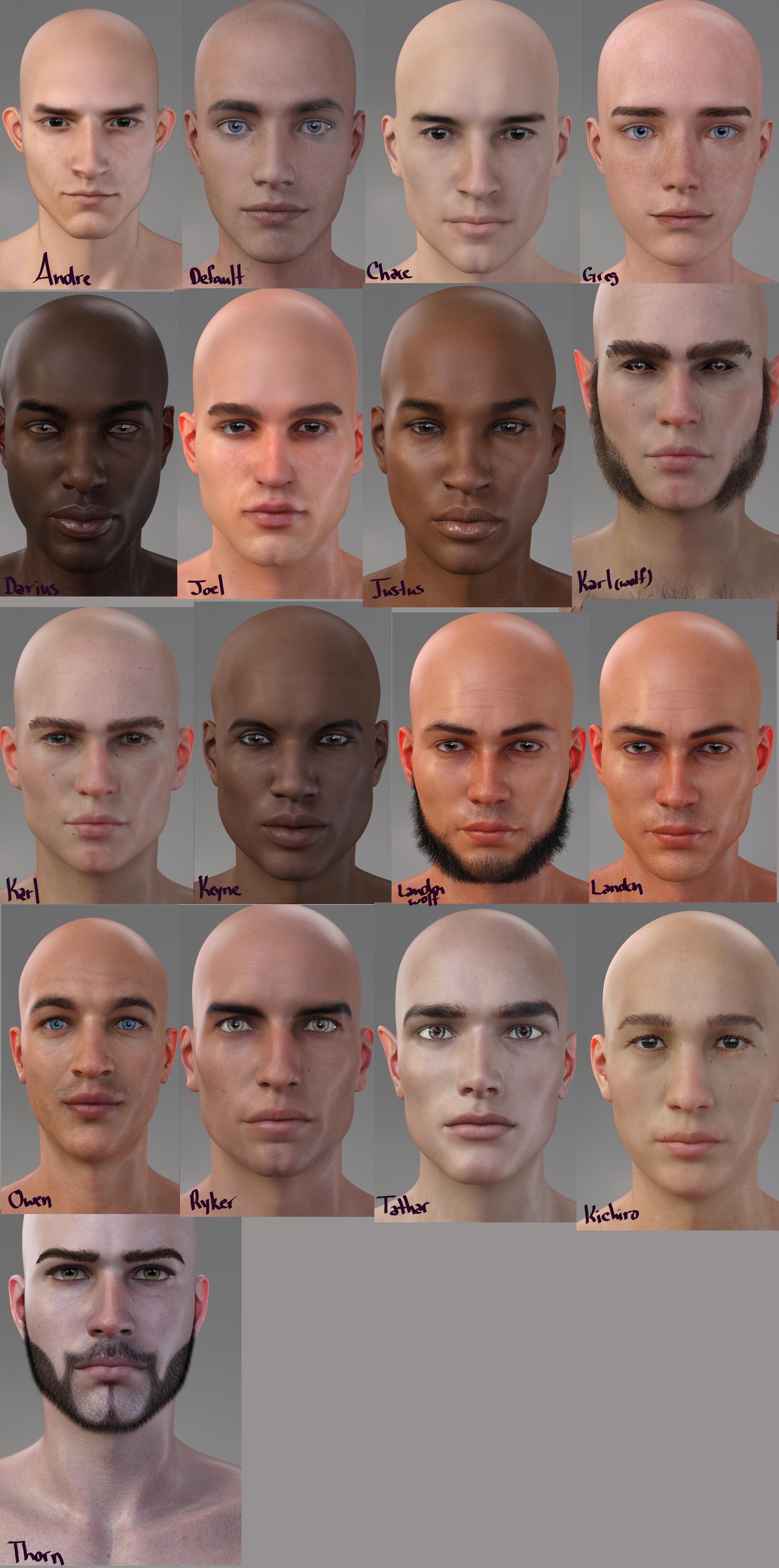

    Here's my contribution to the list. This post was really helpful for me so I hope I can add to it. I didn't have the same light setup so just used what I had consistently across all the faces. Click the image or the attachment for the full size:
    2803 x 5644 - 8M
