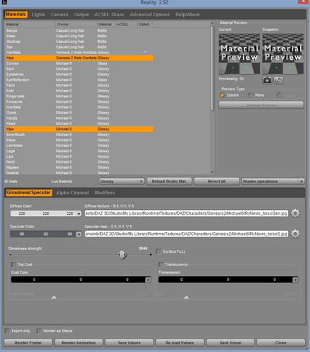

    i use RealityRender plugin..
    i noticed that there are 2 Hips in the list materials

    Actually, it may not be the HD morphs. The issue is that there are two hips and genitalia surfaces, one on Genesis/Genesis2Male itself, and one on the Male Genitalia figure, layered on top of each other, and doing very different things. This has come up before, but I only just now remembered.
    The next version of Reality is supposed to be able to tell Lux how to handle the layers, but right now, it can't. Reality 3 isn't due out until later this year, I think, according to what Paolo has said elsewhere.
    Luxus does tell Lux Render how to handle the layers, but is in some ways more difficult to use up front. That said, I haven't used Luxus with G2M, so I don't know if it's an issue there again.

    Vwrangler is right about this issue in the current version of Reality for DS. It applies to all GeoGrafts. Two versions of each GeoGrafted surface are exported to Lux, one of which is at base resolution, so they overlap. Currently you can eliminate the unwanted low resolution copies by either editing the .lxo or (more easily) by exporting the scene for Lux and then manually deleting the surfaces from the objects folder created by Reality for use by Luxrender.
