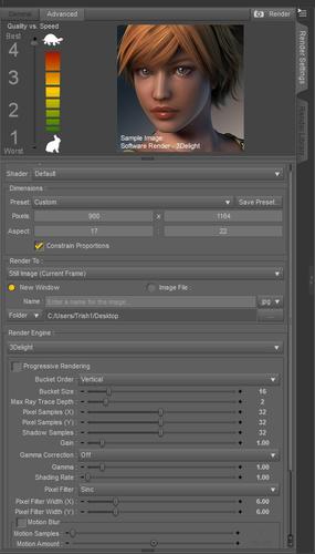

  • TrishTrish Posts: 2,625
    Here are the settings I run with and I have no problem with crashes....Trish

    Hardware assisted renders is only supported for Graphic cards that have the FREE RAM and or Speed to render the image sent from DAZ Studio to your GPU at its default render settings, the GPU not DAZ Studio. Can your card support the textures, render size, and output mode you have selected? If its just on the edge, do Render to FILE and not to window, as your GPU will be used to Open and display the window as it tries to render the file sent to it.
    I think it IS a driver issue...a 7970 should have enough power to handle that scene...does it come in anything smaller than 3 GB?
    But, AMD is rather notorious for having buggy OpenGL implementations, so driver roulette is the rule of the day.
